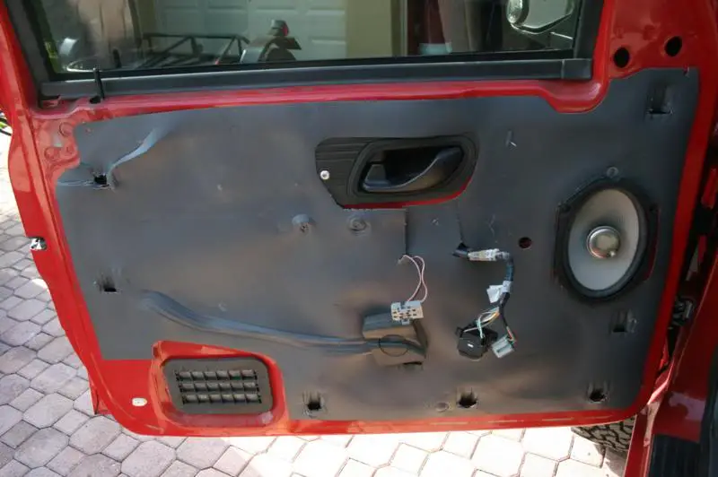

First thing we're going to do is the front doors. Remove the door panels from them.
Take the vapor barrier off and throw it away.

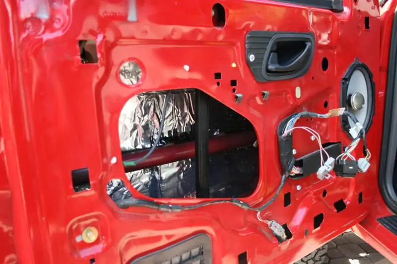

The outer door skin must be covered in deadener fully. You need to cut the pieces up and use the access panel to install it through.
Deadener installed. You don't really need to use any on the impact bar since it is so thick.

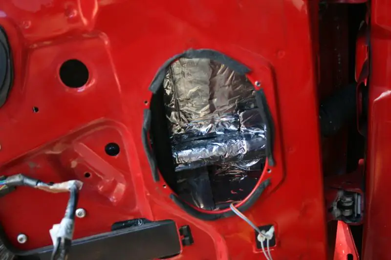

Now move on to the front of the inner door skin. Remove the speaker and install through the opening. You will notice I used some on the impact bar, since it is directly behind the speaker in this spot I would recommend using a small amount there.

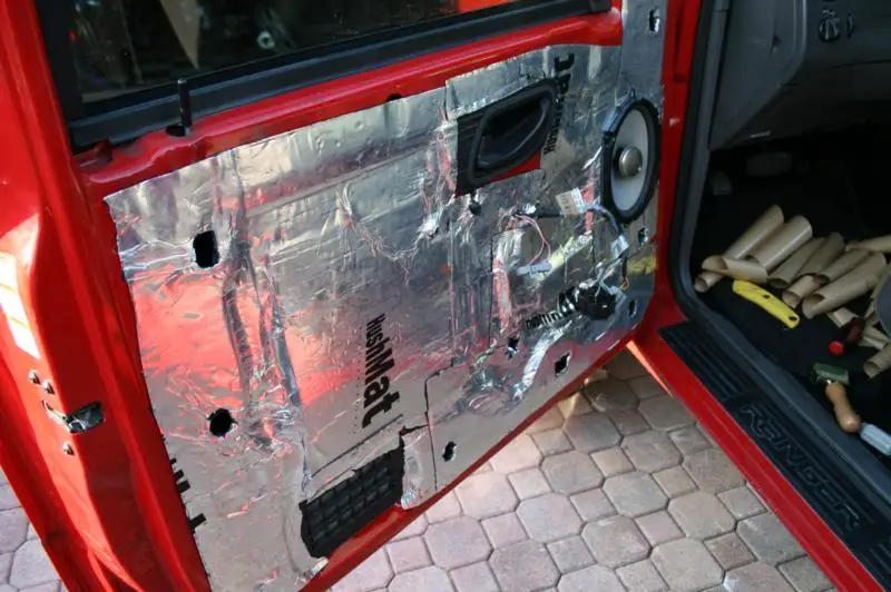

Now cover the inner door skin. As you can see I sealed and covered the entire main access hole. This helps with midbass response from the door speaker and made a big difference. I cut to shape and then attached some thin sheetmetal and covered it in deadener. You can seal off any other openings that are not used to hang the door panel.

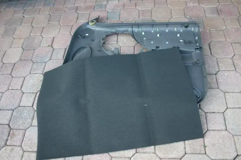

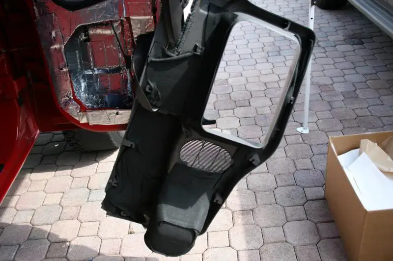

Next we need to cover the door panels in the closed cell foam. This will help with road noise.
The foam is self adhesive so cut any openings out and then attach it. You can see I attached a couple pieces of the scrap I had to cut out. You can't have too much when it comes to this. Door is now done and ready to be put back. Repeat on other side.

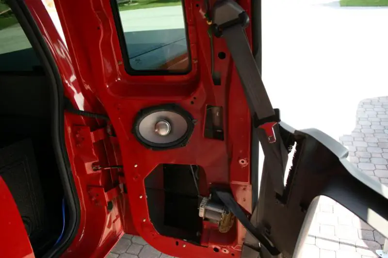

Now we move on to the rear doors. You can kind of just let the door panel hang out of the way instead of removing the seatbelt to remove it.
Again, cover both the inner and outer door skin in deadener.

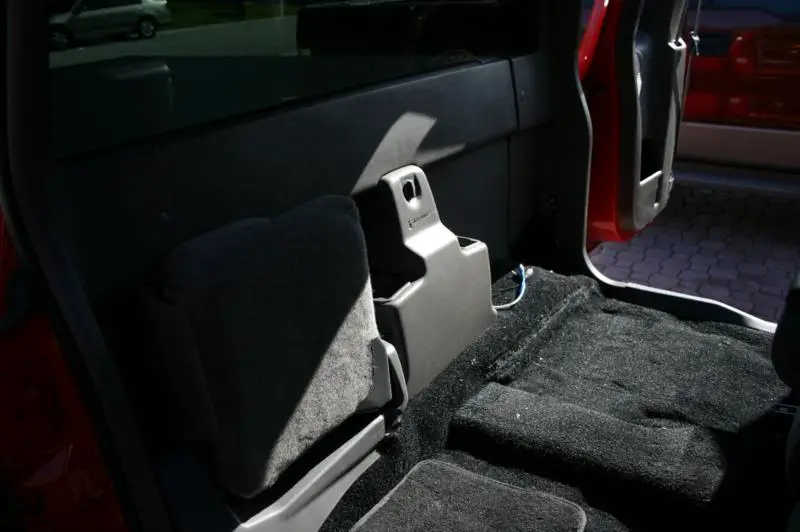

Cover the door panel in closed cell foam. It is a little more tricky than the front doors. My main focus was on the area inside of the little cubby. Now the back door is done. Repeat on the opposite side.
With the doors taken care of we can move onto the floor. I preferred folding back the carpet and doing it in two parts as opposed to removing the carpet completely. Vacuum the floor first. No other cleaning or surface prep is required with HushMat Ultra and the adhesion is guaranteed on every box.

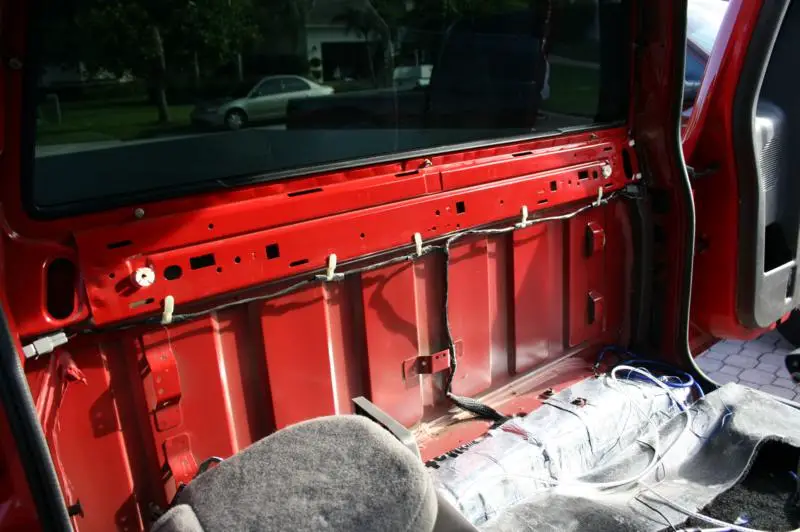

Next up is the back wall. All of the trim must be removed.
Trim removed.
Apply your deadener to the back wall, making sure not to cover the trim mounting points. Back wall is done, reinstall trim.

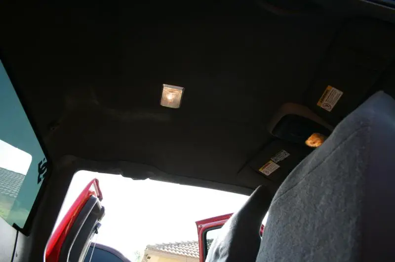

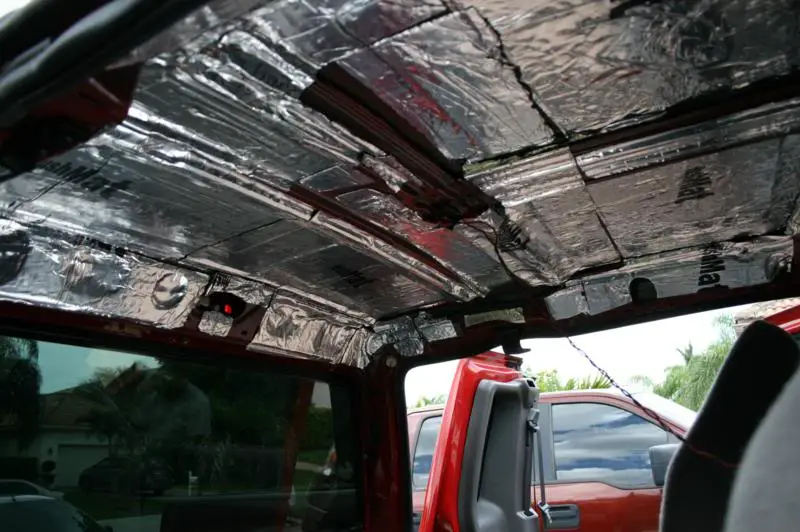

Finally we have the roof. The headliner must be removed now.

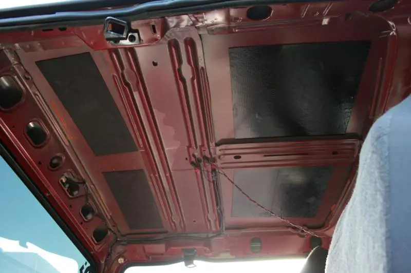

Headliner removed. You can see the laughable amount of OEM dampener.
Cover with deadener. As you can see I didn't cover the roof as thoroughly as I did the rest of the truck. This is because I ran out of deadener. I would reccomend buying 110 square feet as opposed to 100 like I used. Reinstall the headliner and you are done.
The truck now feels much more solid driving down the road. The best way I can describe it is feeling like a new fullsize truck and not a ranger. It is much quieter inside as well. My midbass output is much much greater now and before the install my subwoofer was much quieter if I had the windows up versus down. Now it is about the same with the windows up as it is down, a definite improvement.
