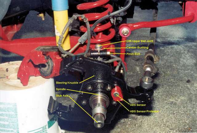

OK i have a 1993 ford ranger xlt 4wd 4.0 i just replaced my auto hubs with the warn locking hubs. But for some reason when i engage my 4wd and the side pass axle shaft rotates it is pushing out into the hub and causing this coil looking washer to pop off the cam inside the hub and it makes a grinding noise and pulls to the left. its not the hubs i have replaced them and it still does this. im stumped to what it could be . bad u joint bad shaft i have no idea. anyone ever heard of this ?
below is the (coil looking washer looking thing that keeps popping out. it isnt the picture of mine but it is the same thing)

Did you remember to install the splined washer and c-clip at the end of the axle? its job is to keep the axle shaft from pulling back in.
~Mark
yes but the shaft isnt sucking in its pushing out in to the hub popping that washer out of the hub. im lost it has new hubs and bearing. with the wheel off i got to turn it with the hub by hand in locked position and it pushes the hub from the rotor.
Oh, so your axle is going out, not in.
Sounds like your c-clip in the diff is missing/broken/off. To tell for sure... Pull off the hub/rotor/bearings and see if you can pull the axle shaft out.
The C-clip within the diff should keep the inner shaft (the one going in the diff) from moving. I should barely move. If you can pull on it and have it pull outward your c-clip came out.
You have 2 choices. replace the c-clip on the end of the axle in the diff OR look at the c-clip eliminator made easy thread and do that mod.
~Mark
edit: I found the thread. http://www.explorerforum.com/forums/showthread.php?t=256302

I'm confused :scratch: The Front axle on the Dana 35 will not simply come out through the spindle.
It won't come "out", but it will pull some. if the c-clip isn't on the end within the diff. The inner shaft should not pull out at all.
Now that I think about it though, you should be able to do this test without pulling off the bearings or rotor.. Just grab the inner shaft on the passenger side and pull it towards the outside. If it moves, the c-clip is not there.
The slip joint is probably close to frozen and the slip joint boot is normally very stiff so when you move the inner shaft the outter shaft will try to move too. Thats why I was thinking pulling the bearings etc, BUT, I forgot to say pull the spindle too But you should be able to tell if the c-clip is missing even without pulling the spindle.
