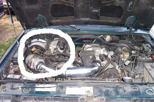

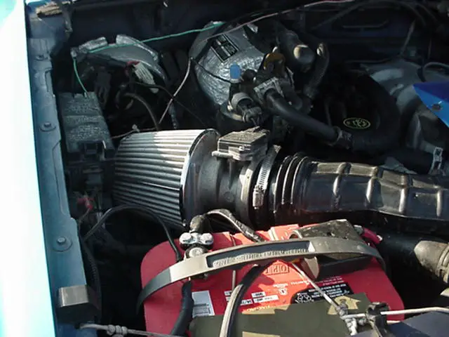

hi guys... i broke a part and have no idea what it is or what it is called..... it has a few inlets to it and is a piece of plastic near the passenger side firewall.... can somebody please scan me a pic of this area? also, the piece appears to have a vacuum sensor connected to it.... and when i disconnected it, i heard hissing and radior fluid came out of where i broke it at.

HERE IS ONE

Is is a little domed cylinder type thing? If so, it's probably your heater control valve. Not a big deal, in fact they fail all the time.

the part i need is made of plastic and has the green lines below going into it.... the part is located somewhere in the white box..... those green lines contain coolant and go into the firewall

Those two lines going into the firewall are your heater hoses. One goes into the heater core the other is the outlet. I'll see if I can get a pic of mine, I have a '91 so I don't know how much of a difference there is from a '94
Well like I said, if it's a small grey/black plastic dome type thing with vacuum and coolant lines; it's most likely your heater control valve. And they're usually around $70. Get a new one.
it isng going into the firewall i need.... but the part both those lines connect to in the white box area in the pic..... there is also a vacuum sensor on it.. it looks like a junction T fitting but has multiple outlets
it isnt a plastic dome it is a fitting that ties in a bunch of differt lines... like a splice or a "T" but with more lines than 3
Yeah it's the heater control valve. The vacuum line turns it on and off, but I don't remember them costing that much.
Thats right. 94 was the first year to have one.
How do I know? Well I have an 88 BII and the hot air comes pouring through the vents on hot days, even without the vents open. So when I found out about this baby I installed one on my 4.0L bII.
The part in question is in fact a heater control valve. Basically when you turn your heater towards the hot side (Sends vacuum to the switch) of the guage it opens and allows hot coolant to flow into the heater core. With the heat control switch in the cool position is bypasses the heater core and no hot fluid makes its way in there. This way the hot summer air doesnt get heated up even more on it's way through the heater box.
