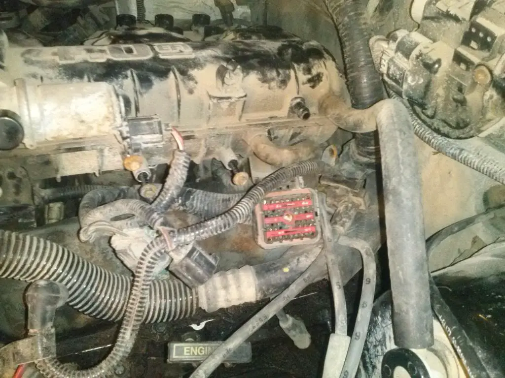

Pictured is where I'm having problems...
I can't remember which line goes onto the throttle body
and I can't remember how all this goes back together...
Thanks guys!!

Which ones are you confused with? Just start pushing stuff together, plugs will only match with the right end. Should be a diagram on here for the spark plug wires. Vacuum lines are pre bent so they'll kinda tell you where they go. And again, generally only hook up to 1 spot.

if you look at the 2nd pic... there's a rubber hose on the back.. it could go to 1 of 2 ports.. I've put it on the bottom one... I can't remember what goes to that tube on the TB and I can't remember which vac line goes to which... I may be missing something... so, if someone would be willing to throw up some pics of a fully function 00 OHV I can get this beast up n running tomorrow and to it's new home next weekend :D

Bottom picture is missing DPFE sensor and the black capped sensor. The 2 wires hanging in the middle of the picture goes to those.
The vac line in the bottom left goes to the upper intake manifold next to the brake booster hose.
The vac line hanging by the AC compressor in the first pic goes to the black capped thing (the plastic thing next to the DPFE sensor)
DPFE sensor has 2 vac lines connected to the egr tube
Google images might help ya out, I've had to use it back in the day lol

Ok, good luck with it. BTW run your spark plug wires before anything. Way easier to run them through the manifold without all that crap in the way
