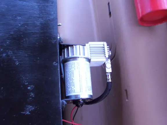

I installed the Viair 100AT today so i can deflate and inflate on the trails! i still have to order the 2.5 gallon tank to go with it but for now i just have the compressor working. i attached it to my custom tool box. I have yet to use it but will after i get the tank. Thanks to Billy for helping me try to figure out how to put a switch in. i now know how to. Here's some pictures.

looks awesome man..
I think that's the sameone i have. Does it shut off at a certain PSI? Mine doesn, but they make switches for that, i might try to find one. How did you run your switch, just tap into the power wire and leave the switch on the compressor on? Looks gave Dave.
Haha...that damn ground!!!!!! :mad: :) :p
haha yeah i know right billy!
Josh: i ran the switch so it comes on when the switch is on and off when off. i was about to ask you about the shutting off at certain PSI switch but no i don't have that. when i get the tank i probolly will get it. i can't figure out how they work though. does it screw into the tank and when it get a certain PSI it tells the compressor to turn off?
I'm not sure how it works. Obviously it has to tie into the tank or line somewhere. But i don't think the 100 series shuts off, it continuosly runs. It gets pretty warm, so be careful with it.

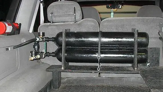

Here is a picture of my setup. I have 2 smaller tanks that i welded togther, they are joined by fittings up top and i also have an inlet and an outlet on it.

Where are you planning on mounting your tank? If you don't run a spare tire underneath the rear cargo area, it would be a great place to put the tank, you just have to make sure it's up out of the way.
mine will be beside my tool box in the rear.
