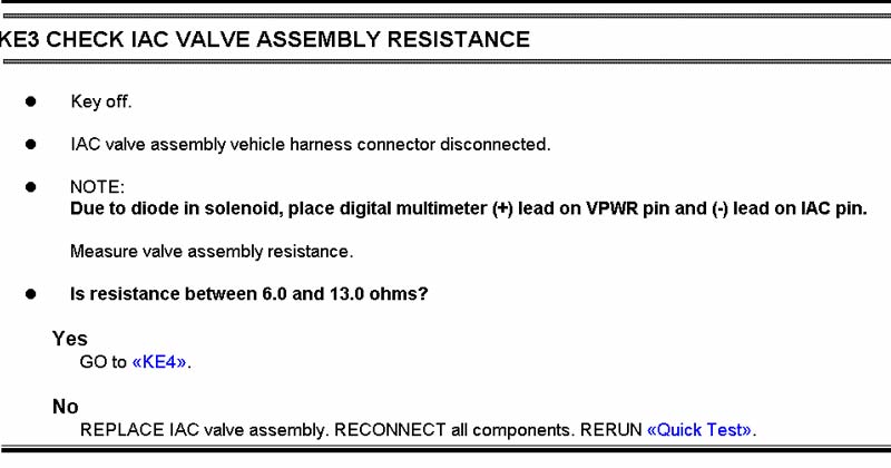

You should check the resistance of the IAC again, make sure to observe the correct polarity because there is a diode in the circuit . VPWR is usually a red wire.
