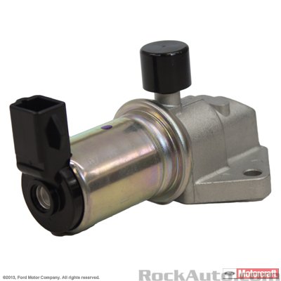

The difference I see on Rockauto pics is CX1845 has a different connector with an interior side key slot and a latch tab on the opposite side.
http://www.rockauto.com/en/moreinfo.php?pk=382795&jsn=3
CX1846 has more rounded connector corners, 3 exterior side keys and a different latch on the wider side:
http://www.rockauto.com/en/moreinfo.php?pk=382796

Good eye! I didn't notice the connector. Mine is the more expensive 1845. Will look for more photos to make sure they photos all match the description. Thanks!
