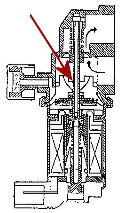

Cleaning the IAC can definitely help, IF it's the cause. I also prop mine up on end for a few hours to let a drop of light (~5W-20) oil run down into the shaft bushing.

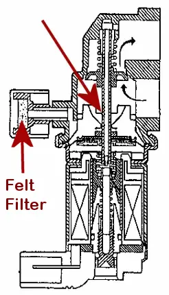

Just adding to the excellent IAC diagram that @J_C provided;
There is an aspirin size, felt material, AIR FILTER within the Black Plastic Cap that is to the LEFT of the red arrow in the diagram (ABOVE).
Depending on the age of the IAC, over time and environment, that felt pellet can get clogged solid, and make the IAC operate erratically - i.e. Idle Speed Hunting - up/down.
The black plastic cap can be carefully disassembled (from the underside) and you can remove & wash out the felt pellet in warm water.
You can also construct one out of thick felt material (which is what I finally had to do after the original pellet eventually disintegrated from washing).
The filter is necessary to prevent underhood dust from entering the IAC as it pulsated backwards and creates an vacuum inside of it.
Hope that helps!
Yeah I clean that filter every once in a while when cleaning the rest. Think it's just a friction fit cap that gets gently pried off - probably better to do this when the plastic isn't cold and brittle.
