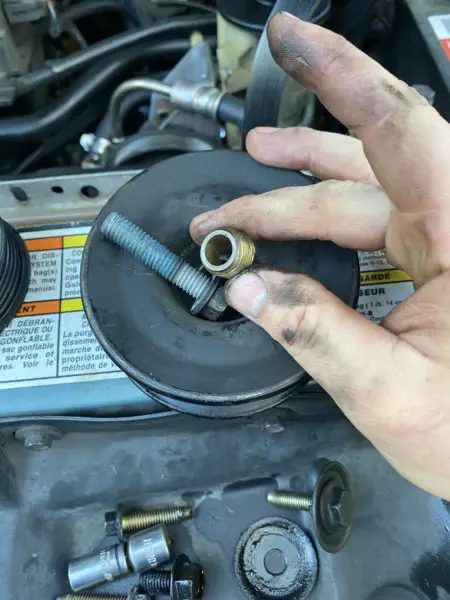

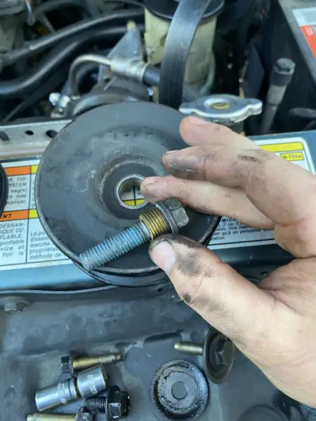

Anyone know where I can buy the proper bolt for this? I’m actually a little impressed with this. Clearly this fell off at some point as it’s the wrong pulley and there is blue lock tight on the fabricated bolt.
Oh weird, ok. I don’t know where this pulley came from, it has a flange on both sides where as OE has none. It’s not a big deal, this one is not why I have this apart. My tensioner pulley bearings are bad and I figured I would check them all/replace while it was apart. Thanks!
I kinda figured it would look something like this maybe.

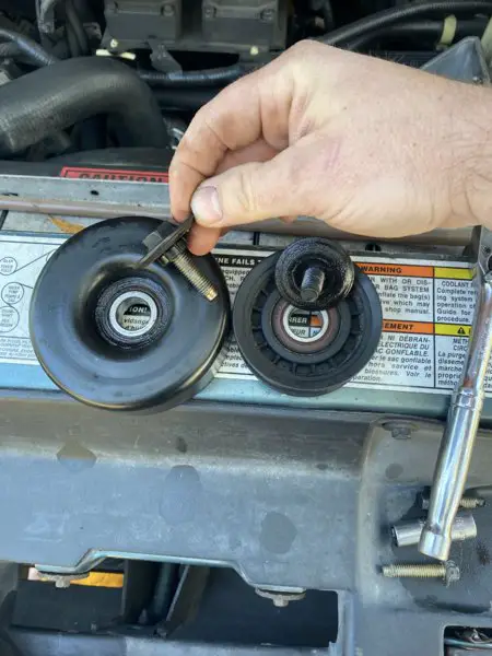

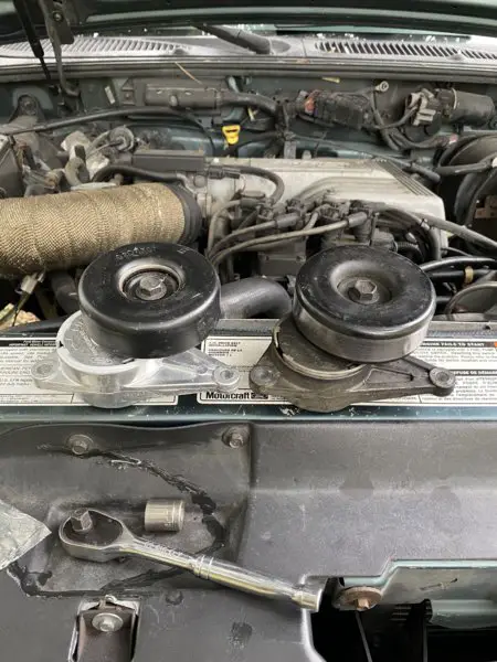

Wow! Ok thanks bro! I’m having a fun time with this fix, bought all three pulleys, the one for the tensioner didn’t fit (still running that rigged up bolt on the idler) so I bought a whole gates tensioner. Installed it and the pulley bolt stripped out when I tried to install the belt! Lol so I found the oe part number from ford and found one for $40 on amazon.
Motorcraft BT40 Tensioner https://www.amazon.com/dp/B001CA5372/ref=cm_sw_r_cp_api_i_MCElEb5TDDTBX
Update: the amazon parts appear to be legit. Just dropped this factory tensioner in, only started it up but I think it’s good. The part and box looked like ford dealer parts.
