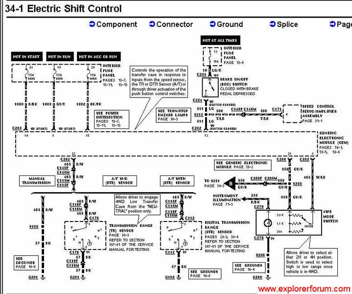

Guys I had been thinking about this but havent had time to work on it...
Instead of installing a switch to work relay/brown wire mod, How about installing another relay thats normally open or normally closed and tapping the AWD switch position...
By tapping in I mean NOT cutting wire from the AWD switch, just connecting a wire to it to power the second relay...
This way when in AWD mode you disable automatically the front with the brown wire mod... And then you switch to 4x4 hi or low that second relay toggles and engages the brown wire relay...
I just wanted to share this... I will eventually play with it but again I have no free time at do it at the moment...
