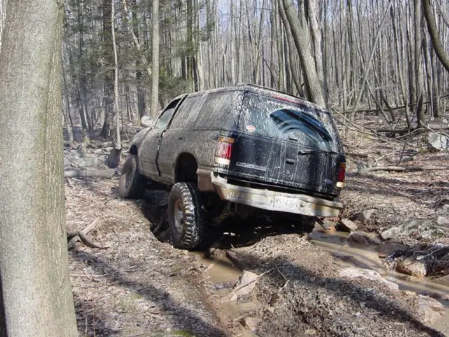

I had a similar rig like yours.. 97 with torsion twist and 3" body lift. I was capable of running upper blues all day at Rausch Creek many years ago.. Just look thru some of the old albums and trip reports for all the runs there.. We did many guided runs for many years
Wow. That was eye opening. I was just worried about the capability of ifs. Since all of my friends are Jeep owner's. And they all have solid axles. Obviously. I thought that ifs is not as capable. But I also heard the Dana 30 or 35 is weaker than the explorers ifs? Idk. Either way Thank you for you replies.
But would one of those kits help out?

A lot of it's capability is with the driver (a good driver with an IFS rig can go a lot farther than a mediocre/average driver in a Jeep or other SA rig).
I would put the driveline parts of the 2nd-gen's IFS maybe about on par with a YJ or XJ Dana30 strengthwise (and a little stronger when it comes to the housing/suspension itself), but of course it still won't have the articulation ability of the SA.
Unless you're doing a lot of high-speed "prerunning" stuff though (or you intend to), I'd lean more toward the SAS over spending the bucks on a high-$$$ IFS kit. The return on investment with a SAS is much better for general trail work/crawling due to it's greater flex and much easier upgradability. The IFS has a myriad of parts that would need upgrading for the same level of trail performance (CV joints, half-shafts, A-arms, ball joints, etc.), and eventually you'll reach the limits of it's centersection (gears and diff housing) where there's little else left you can do other than swap it out for something bigger as well (at which point you may just as well just do the SAS anyway).
