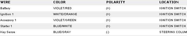

Here is what mine says.
USE A DMM TO TEST THESE WIRES. OR GET A PROFESSIONAL WHO KNOWS HOW TO WIRE VEHICLES TO DO THIS FOR YOU.
