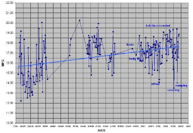

The only new parts mine has is 4 new O2 sensors that were replaced about 3K miles ago. My Spark Plugs were last changed at 50K miles, everything else on my engine has 97K miles on it. As you can see from my graph, mileage doesn't always get worse as a vehicle gets older. The graph below starts in 7/97 when I bought my Explorer new and goes through my last tank of gas from Monday. My trend line has gone from about 15.6 MPG when new to 17.6 mpg now. All of the low spikes are either from towing my tent trailer or 4-wheeling.

Originally posted by Rhett Browning
You have the SOHC, and we're talkin OHVs here. You also have fewer miles than most 1st gen owners. Unless they have lots of new parts, an old vehicle won't get as good gas mileage as it did when it was newer.
200-250 is pretty accurate on city mpg on a 1st gen
300+ is typical on highway
this equates to 13/18
the wishful sticker said 15/20
My 94 with 120,000 miles get's 17-18 city and 19-21 at 70mph.
