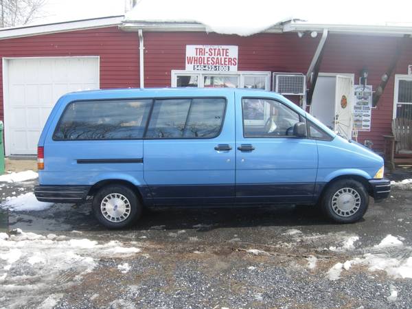

Hi! Been away for awhile.......sitting in sunny FL right now. My question is about those full roof-length rubber or plastic strips which run the length of the roof on either side and if they can leak?
I seem to have a leak inside and I have NO roof rack. The only place I can imagine water getting thru is under those strips, but I am afraid to remove them.Anybody know anything about these strips? Thanks!

Zenish and 92 exp.................you were right! It was leaking from the shrunken trim rubber above the left side windows. Pried back the edge and silicone sealed it well. We'll see, next rain................THANKS!
Well, it rain in downpours all day here in FL and not a drop got thru this time. FIXED!
