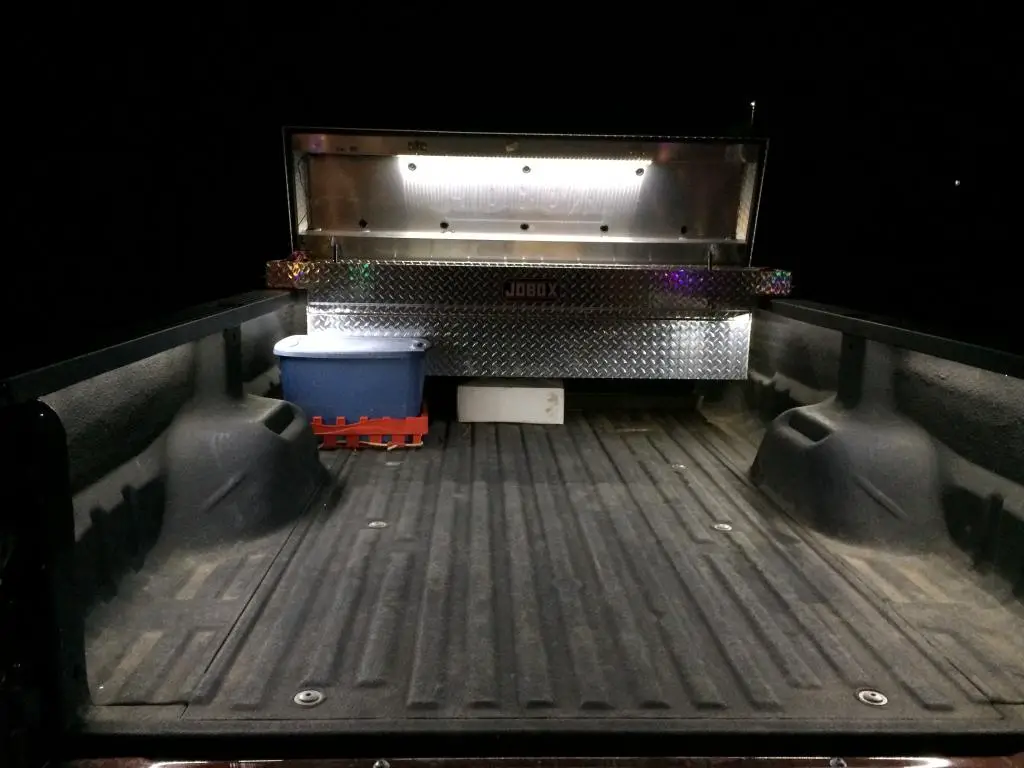

This is a basic writeup. I'll include any tips and explanations I can think of so that anyone with any level of wiring experience can install these. My truck has an 8ft bed and the way I installed everything, you cannot see any lights or wires (or the switch) without having your head below the bed rails. Hiding them was a priority for me, but I still wanted the switch to be easy to get to inside or outside the bed and obviously light up everything.

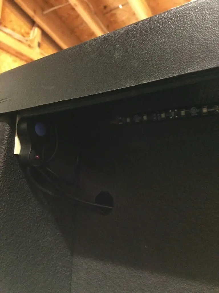

2. Determine where you want to mount your switch. The strip from SBLs has ~2ft leader between the light strip and the switch. Put this light on the passenger side with the 12V outlet. If it can reach, run the extra wire to the 12V access hole. If there isn’t enough, don’t worry about it until Step14.

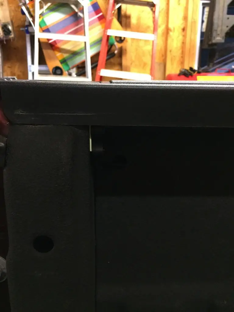

3. Determine where the rear end of each light will be and where the wires can go through the bedside without kinking (probably an inch or so from the light itself).
4. Drill a small hole just large enough for the wires to fit through. Keep in mind you will want the connectors to fit through too (So ~3/8” or so).

17. Once everything works, use rubbing alcohol and a rag to clean off the mounting areas of the lights and the switch.
18. Heat up the tape on the strips and the switch until it’s tacky and stick to the bedside. This lets the tape bond better.

20. Enjoy being able to see in the bed at night!
