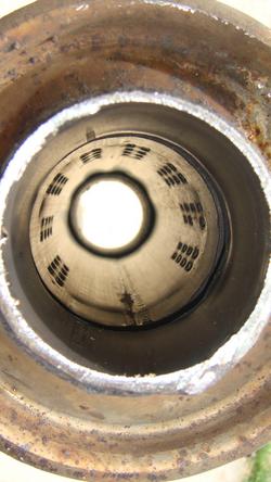

Although Thrush and Dynomax are owned by Tenneco, it's difficult for me to make a comparison because my Dynomax Super Turbo is a completely different design and likely much quieter than your two chamber Thrush Welded. Super Turbo note is low but very tame. I removed the resonator, ran it over the axle reusing the curved pipe going out the side, and straight out the back under the bumper. Slight increase in loudness without any added drone or rasp at highway speeds. If I had to guess, about a 2 dB loudness gain from the drivers seat. Your plan would likely be more dramatic running the tip in front of the right tire. It's difficult if not impossible to make V6 engines sound decent, especially these SOHC's. Sounds OK up to about 2500 revs, anything above sounds ricey IMO. Contrary to what some people claim, a V6 will never sound like a V8 regardless of displacement, it's all about harmonics. BTW, there is only ONE resonator, and it's located directly behind the muffler.
Internal resonator pic if you're curious.
Although Thrush and Dynomax are owned by Tenneco, it's difficult for me to make a comparison because my Dynomax Super Turbo is a completely different design and likely much quieter than your two chamber Thrush Welded. Super Turbo note is low but very tame. I removed the resonator, and reused the curved pipe going out the side, and ran it back under the bumper. Slight increase in loudness without any added drone or rasp at highway speeds. If I had to guess, about a 2 dB loudness gain from the drivers seat. Your plan would likely be more dramatic running the tip in front of the right tire. It's difficult if not impossible to make these V6 engines sound decent, especially SOHC's. They sound OK up to about 2500 revs, anything above sounds ricey IMO. Contrary to what some peple claim, a V6 will never sound like a V8 regardless of displacement. It's all about harmonics. BTW, there is only ONE resonator located directly behind the muffler. Here's a cutaway pic if you're curious.
Okay sounds good, I was deciding between just cutting out the resonator and replace it with some straight pipe or the reroute out front the rear tire. I think I'll just cutout the resonator section and put in some pipe to replace it. Keep it simple.
Yeah it will never sound as good as a v8, but its good to know there won't be a lot of drone without the resonator. All I need is a teeny bit more volume which hopefully a reso delete will add without excess drone. The thrush sounds mean and throaty under 2500rpm above that it reaches a plateau and it doesnt change tone at all, just a nice low hum. Looks like a resonator delete is in order.
