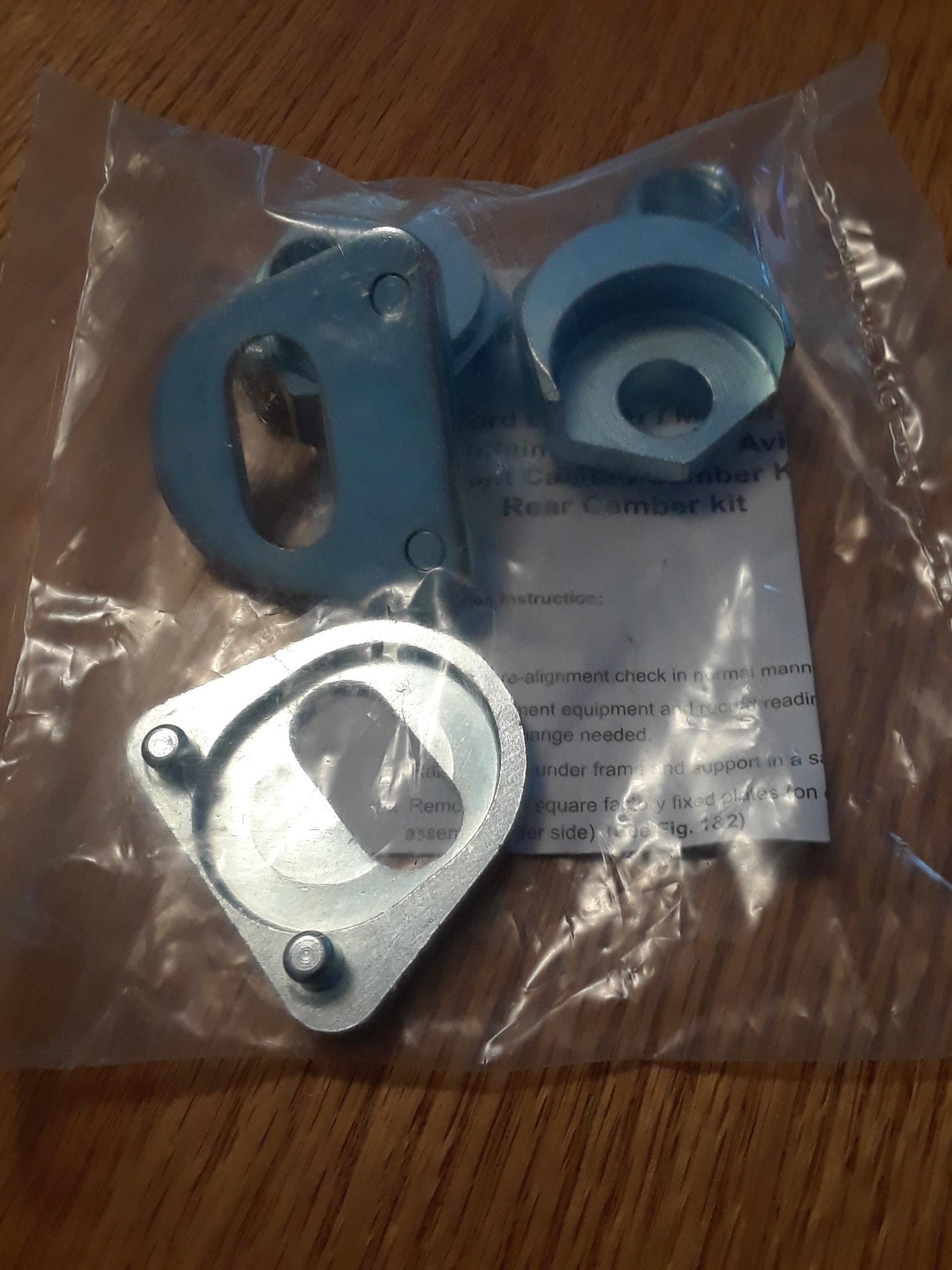

I just bought new tires and had an alignment done and right front camber is out of spec. Purchased a Moog K80111 adjustment kit online from Amazon. The large recessed washer has the locator pins towards the recessed side instead of the flat side.
Didn't look like this would work so I returned it. Purchased from another website and received the same incorrect part. I guess I will have to find a parts house that has it in stock so I can check it before purchase. Correct part should be like the picture in Jeff98735's post so you can install the locator pins in the shim holes and make adjustment by turning the adjusting nut in the washer recess.
Called Moog and they said that they had production problems with this part and some with the manufacturing error are still out there. Bought a set from them, at a much higher price than Amazon of course, but they were OK.

It bears stating that the items in these kits are different; the kits are not interchangeable. The locator pins on the 80112 kits (for the back) are wider than the locator pins on the 80111 kits (for the front). Seems obvious, but you may find that you get an 80112 box from the part shop that actually has an 80111 shim in it because someone returned it in the past.....
