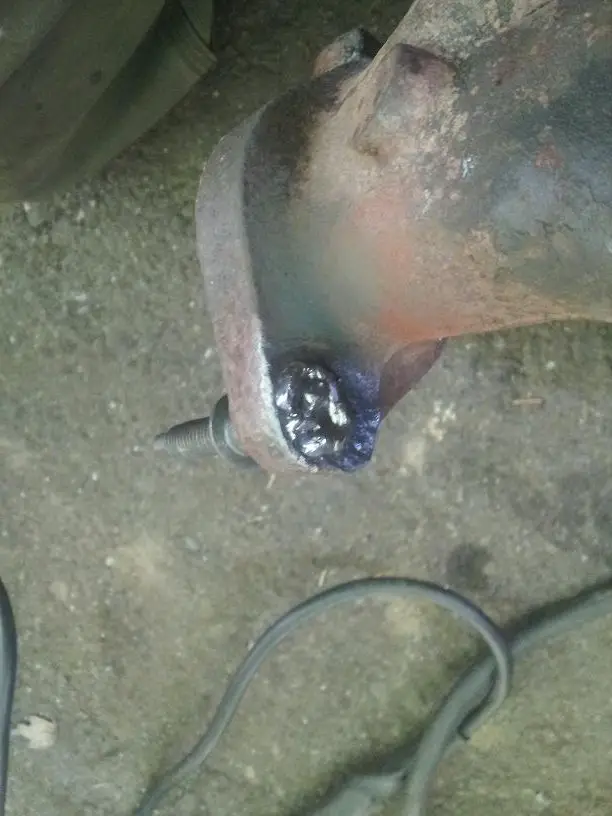

Funny you should mention that. I found the problem but you were the closest.
I drove the truck to work today and by the time I got home, the symptoms were worse and I could smell exhaust fumes.
Well, look closely and you can see the problem (ignore my fuel line shield)
Yeah that whole flange fell away somehow. Here's why:
https://www.youtube.com/watch?v=XvC-OjLpNm8&feature=youtu.be
So I ended up welding that bolt into place.
I then put the whole thing back together and it runs friggin perfect! Now to do something about that fuel line shield...
Looks like the bolts just came out for the shield or did they break off?
I had actually taken them out because I had to replace that entire fuel line. What fun that was...
