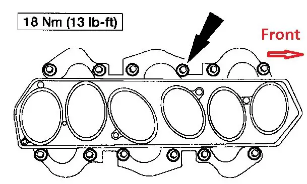

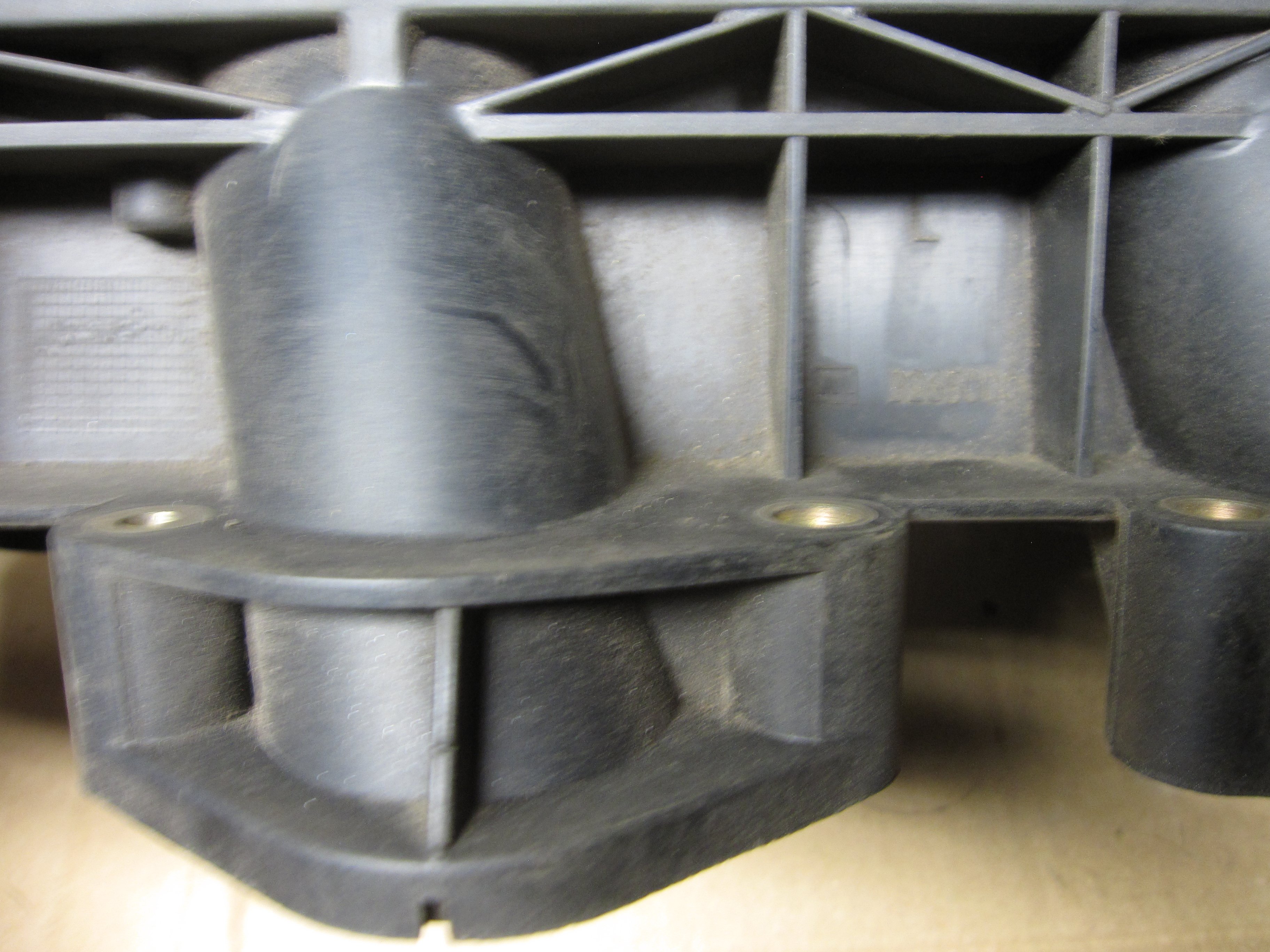

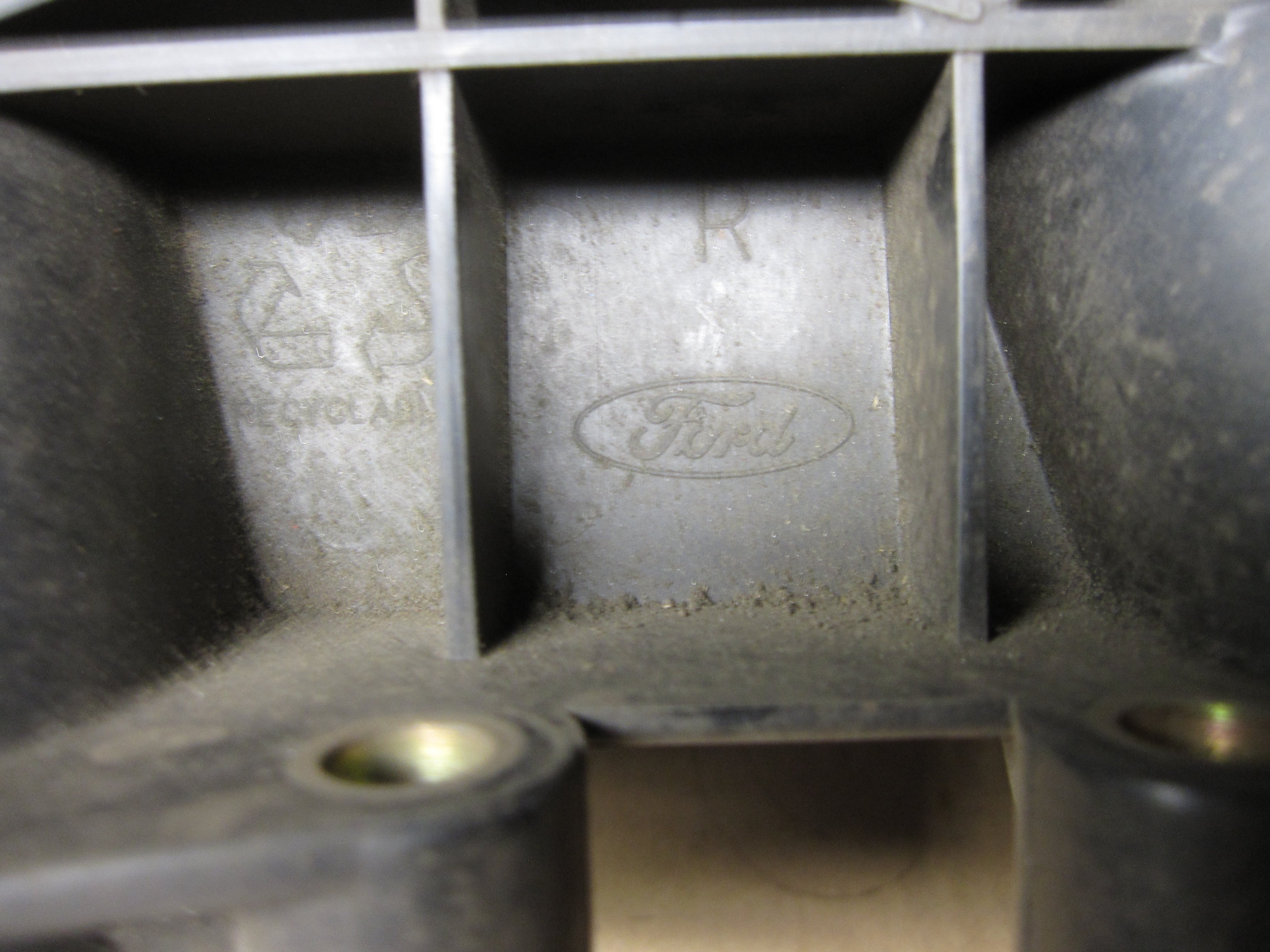

So I've noticed on the lower intake manifold for the 4.0 Sohc it lines up both ways. I see though that it's stamped L on one side and R on the other. I know generally L is driver's side is that the same way on these

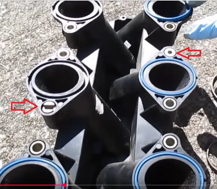

The lower intake only fits in one position, regarding the bolt holes for the upper intake.
I'll have to look again when I get off work but it looks completely symmetrical, like it would line up both ways
Sorry, i am wrong, your are right!
Never had an eye on the L and R.
But it's similar to left bank driver side and right bank passenger side i think.
The only difference is the bushing, and this bushing should be on the driver side (if i remember correctly).
