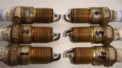

I started on the drivers side with 4,5,6 and had minimal problems. The plugs i pulled out of the drivers side were very dirty autolites.
When i got to the passenger side, i couldnt find my swivel extension, and i was pressed for time so i figured id just try my luck on #2 . When i i finally got it out i noticed that not only was it much cleaner than the drivers side plugs, they were also gapped MUCH narrower, and they were MUCH cleaner.

I believe every 2001-05 Sport Trac had different plugs installed on each bank from the factory, maybe all 4.0L SOHC engines.
Mine came out very screechy at 61k. I applied a very thin coat of copper anti seize on the threads regardless of the Motorcraft SP500 FineWire Platinum replacements being nickel plated. Excessive gap on the drivers side is caused by center electrode wear due to the wasted spark ignition, not from a wider gap setting from the factory. Recommended gap is .054, check your hood decal.

Oops, I missed different "brands" in the OP, not different model numbers. Before racking your brain any further, replace
the two old passenger side plugs. Also make sure #5 & #6 firing order is correct because the coil is not sequential. (4-6-5)

Regardless of brand, wouldn't be the first time a new plug was bad out of the box. Also make sure you didn't break the ceramic.
