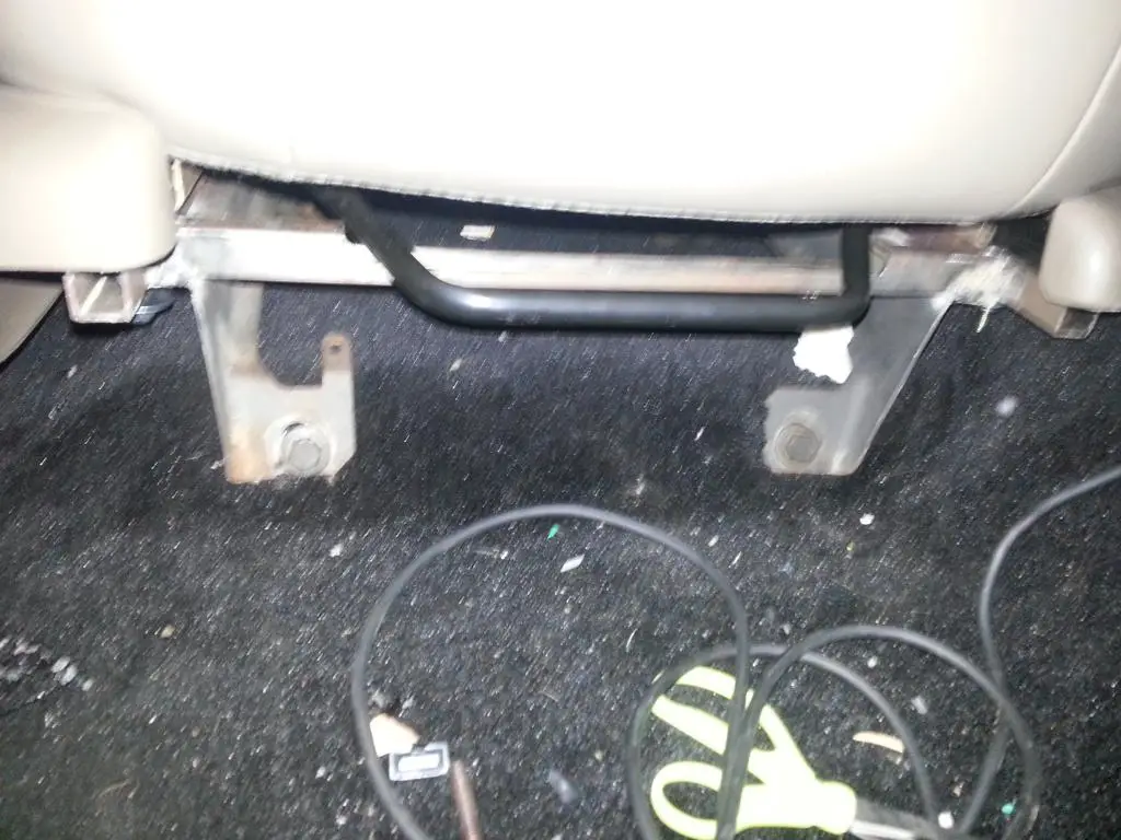

So did the escape seats fit without much modifications
I ground the rivets off of the feet of each seat and made a sub-frame that is welded to the feet of the old seat and then its bolted to the rails of the new seat. I have the passenger seat done. It was my first time wire feed welding so the welds are horrible but you can see them.
