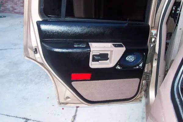

Now the criticism.... I thought about doing the arm rests on the doors the same but I'm affraid of the ware... The speaker cover did you just piant them? Though about that too. :cool: Not to crazy about the glove box door. looks kinda weird. I think it woud be better if it was all painted black. What did you use for paint? I was thinking of doing the whole interior black....but thats alot of work! :eek:
The ware I'm not too worried about, it's a dye that penetrates itself through the fabric and does nothing but that, I did put a protective coat of clear over just to make sure. But as far as I'm concerned, I scratched it, nothing happened, that's all that matters.
Speaker grills.. Kyrlon Satin Black, just make sure whatever you use bonds to metal, or even some Rust-Oleum. Don't forget to sand/prime for a permanant coat.

Whole interior black? Eh, not my thing, I'm a two-tone guy, here's a pic of someone who did their entire door panel black.
