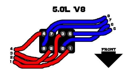

Wires can be a bit tricky using the standard routing (and some of those wire looms can be a pain to open if they're original), but definitely something anyone can do. Do one at a time so you can keep the routing stock (and remember where the wires go). Use OEM plugs/wires for best results. Just make sure you use anti-seize on the sparkplug threads so they come out easier next time, and dielectric grease on the boots for pretty much the same reason. Here is how you handle the firing order for the wires:

FYI, the challenge I see with the wires is they're held in there pretty good by the OEM wire looms which can be a ***** to open depending on where located. My wires are not routed in a standard fashion as I have Torque Monster Headers and my biggest objective is keeping the wires free of the headers (I've lost more than one in the past with poor routing). I also use aftermarket, tool free looms (by MSD) that snap on and off by hand. A little pricey, but I love how they work. Allows me to be creative in keeping the wires clear.

Never heard of B&B or Omni. There are a LOT of aftermarket options out there and quality varies wildly. Remember that the 5.0 is notorious for eating wires because they run so close to the exhaust manifolds. OEM wires include metal heatshields in most applications.
