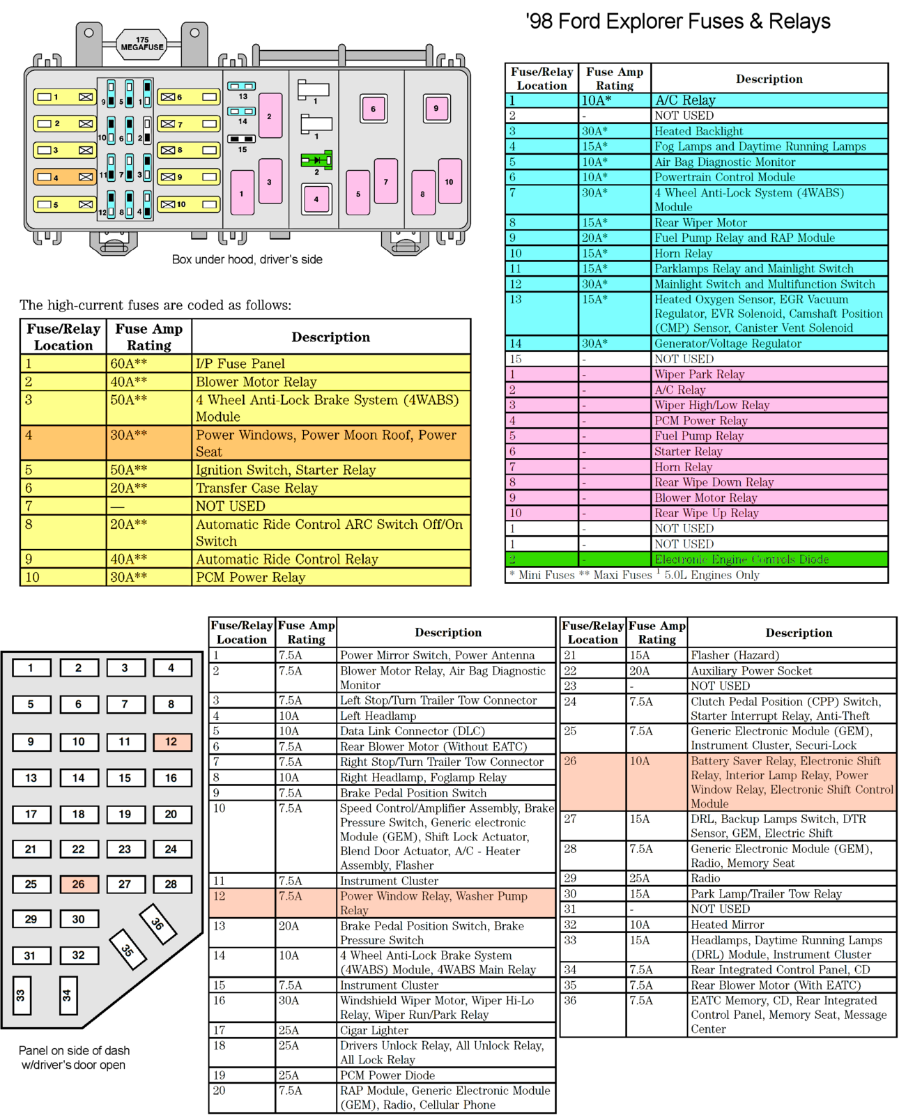

I would've thought bad ignition switch would affect more than just radio, like HVAC blower, and no click sound. Anyway it looks like that might be fuse 20, you could check it for 12V with ignition on the next time the radio goes out.
Alright, update, I have figured out by testing an aftermarket radio for eBay, that it's the constant 12v that keeps your clock set, which makes a lot of sense, that got a fuse?
Looks like fuse 29, assuming your fuse setup is the same as mine.
