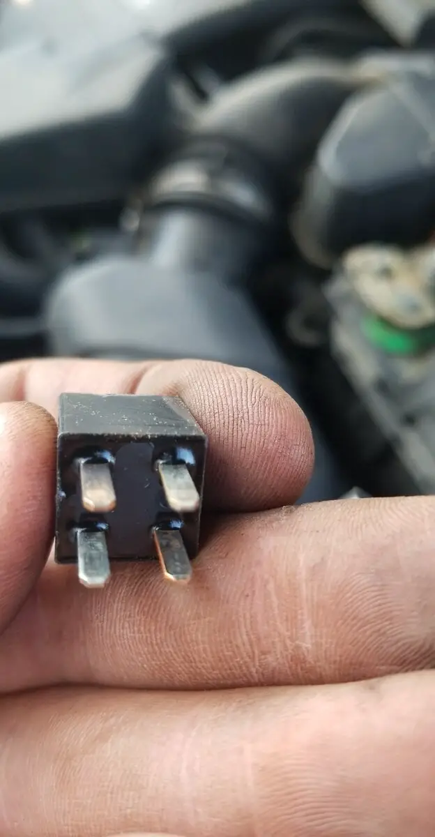

If I've correctly traced through your previous posts, you've confirmed that 1) relay pins 2 & 3 are both HOT and that 2) jumpering relay pins 3 & 5 cause the clutch to engage. Are these still correct observations?
Picture is not of the "right" relay. Its just a picture I took to try and getba pin out. Reds are 12v if I jump either to the green the clutch engages. I believe blue is the control from the computer. It was a very low voltage. I did not check I the the relay was clicking with turningthe a/c on/off. I do know the blue voltage was changing while turningon/off. I know that when I snap the relay in place it clicks. Unfortunately I am out of town for work this week. I won't be able to check until Friday.
Based on what you described, it should be working...
Assuming...if the relay clicks when ACC_CMD changes state, there's nothing wrong with the control circuit. If connecting the "green" terminal of the socket to power engages the clutch, not much left to be a problem except the relay itself or it's socket contacts.
