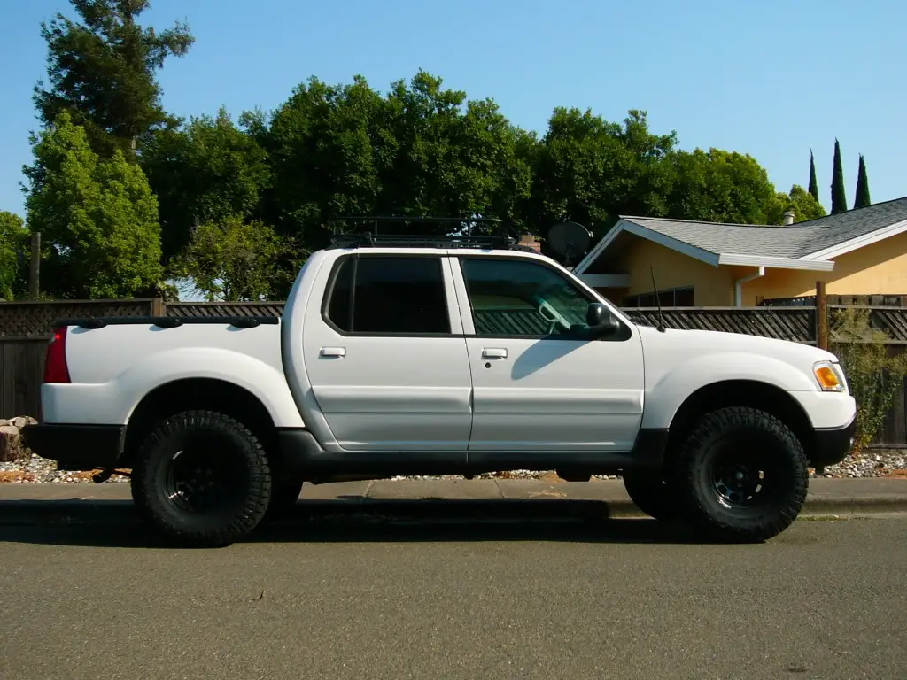

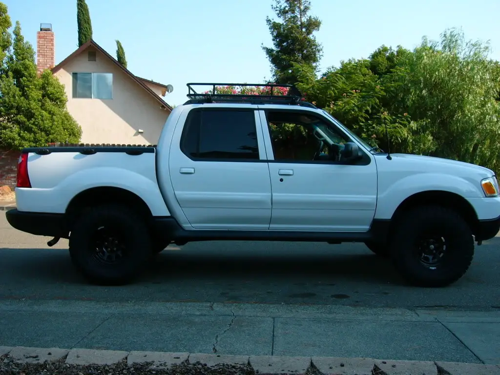

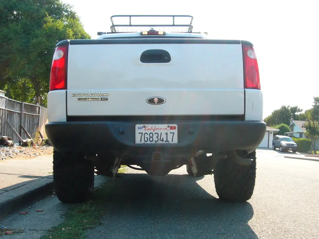

this is my X with warrior #153 shackles and torsion twist to fit 33" duratracs. similar to your plans.
