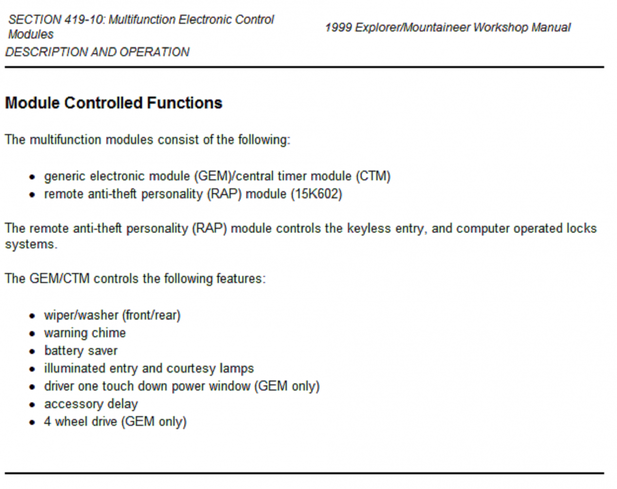

CTM = Central Timing Module. A name used by some automakers for a box with similar functions to Ford's GEM
AFAIK, there is only a CTM on lower level (lesser factory optioned) vehicles, maybe sports or some stripped down Rangers, instead of the GEM which when present does the CTM duty, so no (Ford of this era at least) vehicle will have both a GEM and a CTM, just CTM if the vehicle doesn't have features that need a GEM or vice versa.
I too would first look at relays, particularly the battery saver and accessory delay relays.
After swapping relays around with known good ones, if no luck then there are tests you can do to rule out the GEM. GEM just grounds the relay coils, so manually you could connect a jumper wire between the battery saver relay purple/orange wire and ground which should turn it on. Similarly you could jumper to ground a wire between the accessory delay light blue/red wire and ground to turn it on. I'd start with the battery saver relay both for swapping it and for jumpering to ground to test it because it has to work for the accessory delay relay to come on at all.

AFAIK, there is only a CTM on lower level (lesser factory optioned) vehicles, maybe sports or some stripped down Rangers, instead of the GEM which when present does the CTM duty, so no (Ford of this era at least) vehicle with have both a GEM and a CTM, just CTM if the vehicle doesn't have features that need a GEM or vice versa.
After swapping relays around with known good ones, if no luck then there are tests you can do to rule out the GEM. GEM just grounds the relay coils, so manually you could connect a jumper wire between the battery saver relay purple/orange wire and ground which should turn it on. Similarly you could jumper to ground a wire between the accessory delay light blue/red wire and ground to turn it on. I'd start with the battery saver relay both for swapping it and for jumpering to ground to test it because it has to work for the accssory delay relay to come on at all.

No, you have a GEM because the one touch down feature (in addition to other features) needs it to work, but the GEM also controls the battery saver feature through which all power (to some things) goes through the relays in question, so in theory a bad GEM could cause this but it is significantly less likely, and you could rule out the GEM with the test I proposed previously, that there are a couple wires going to it to activate the relevant relays and all it is doing is grounding those wires from the relays' coils so if you ground them yourself and the problem remains, it rules out the GEM. If you ground them yourself and the problem goes away, maybe it's the GEM, or a wire to it or whatever is supposed to be triggering the GEM to activate the relay(s).
