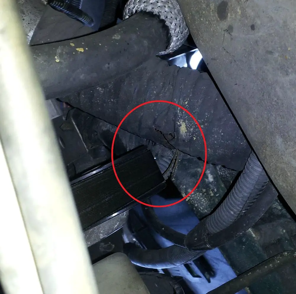

Problem is 75% solved, had nothing to do with the fuel system rather it was with the air intake.
I was going over everything again just to make sure I didn't miss any thing pulled the duct and decided to start it maybe the butterfly valve wasn't opening or some thing. so I pulled the duct and started it. (I still have no idea why I decide to start it but I just had the urge for some reason)
No rough idle at all, started up easy. filter was just changed 2 months back. So now I get to go through that.
However I did take her for a spin. No coughing, no random dying, smooth and plenty of power. But the CEL is constantly on. but at least I didn't spend $80 on a new part for no reason.
Ahh, Mas Air Sensor might be coated with dirt or oil or just plan gone bad.
Replaced the maf sensor, air filter(just in case), and the intake tube, and BAM problem fixed.
Thanks guys for all the help trying to problem solve my issue it helped a lot.
