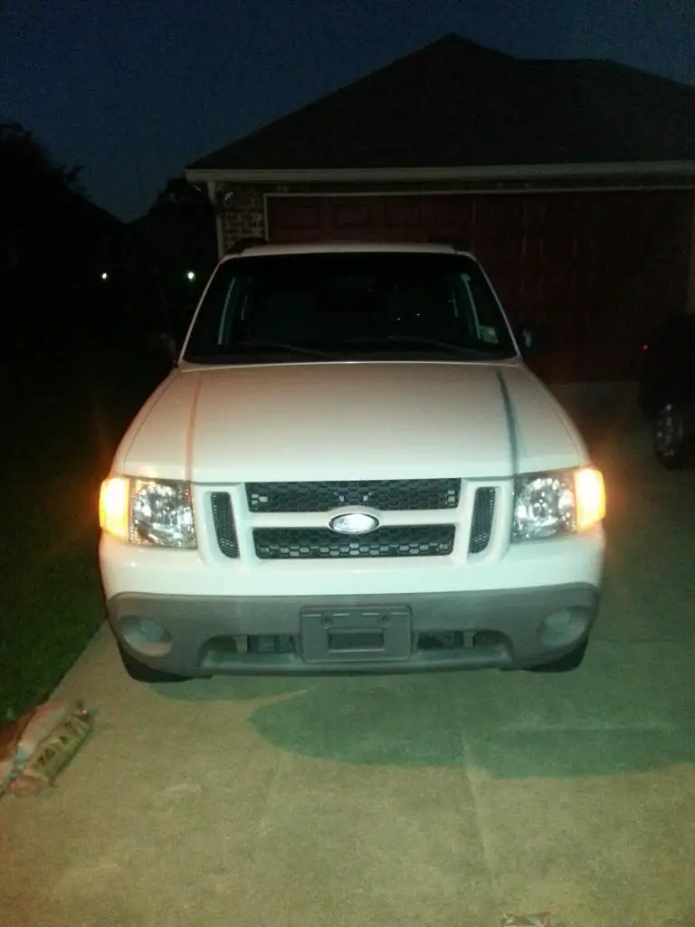

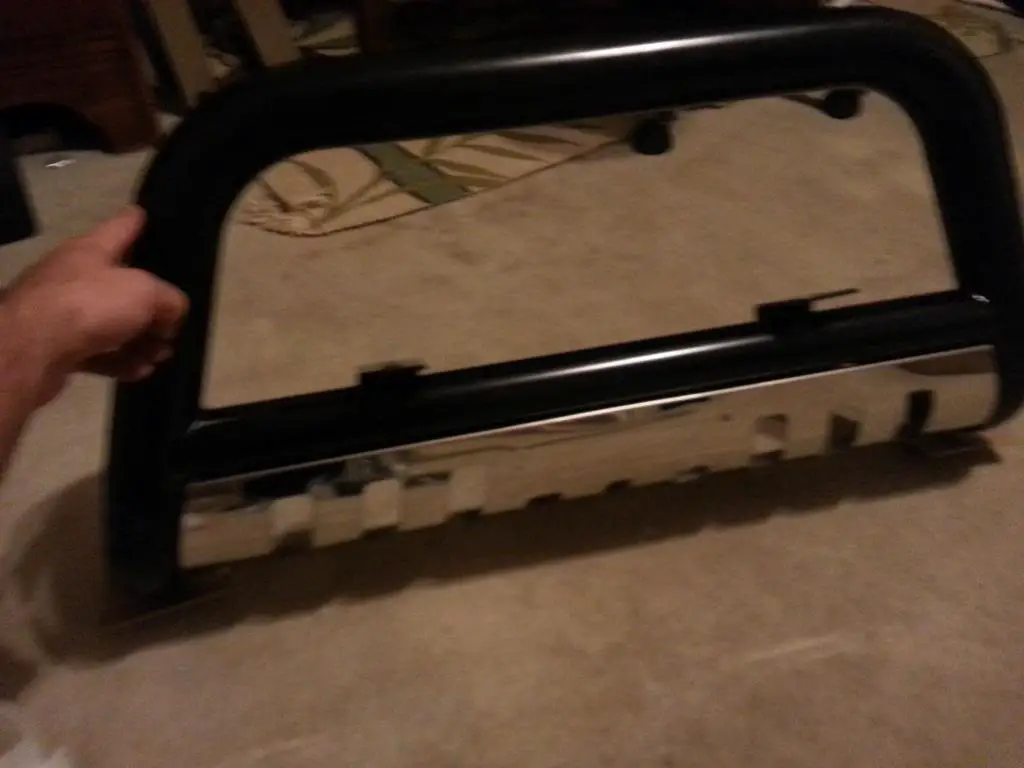

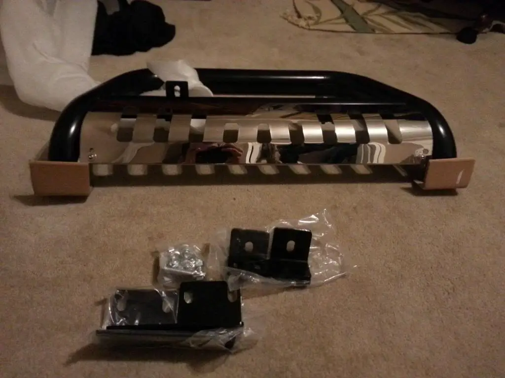

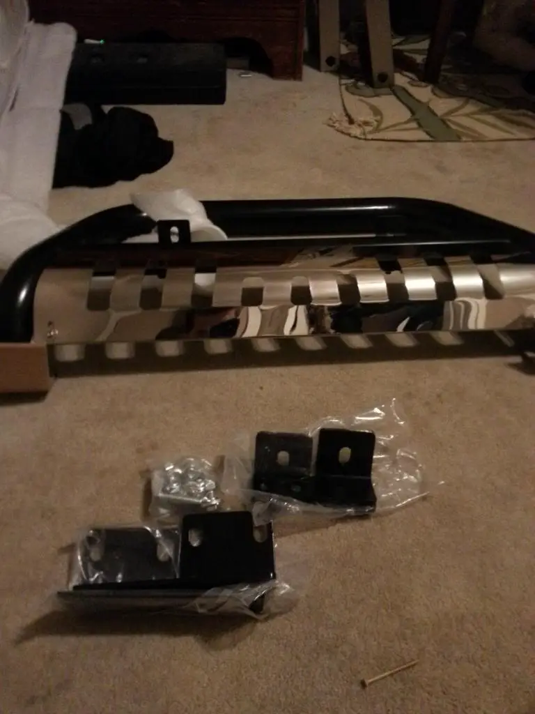

Well not really but still a great quote from the 90's mortal kombat! ok everyone so i have been a member for a few months now and love EVERYONE'S ST i got some good ideas from everyone and i might be stealing a few :) First off let me say that i have a 2001 Sport trac 2WD roughly 79k miles on it, bought it from an old man who took great care the ST all except those cruise control switches as they are literally coming apart. My plans for my ST is mostly for show and reliability. UNFORTUNATELY i WILL NOT be doing the 3" PA BL even though i know that most of the members have it done. Believe me I would if i had the time to invest in doing so but frankly i dont have the patience to lift heavy pieces of metal by hand lol. but i am open to suggestions and you might be able to persuade me. Ok so I ordered a few things and will get started this weekend hopefully it will turn out good. I purchased a Hunter Classic Bull Bar Color is black with SS skid. second item i purchased was a billet grille although after purchasing i found a member here on the forums with a flat black grille which i thought looked amazing, so i wanted some input on if i should leave it chrome or try and paint it. third thing i bought was a Bi-xenon dual beam hid conversion kit (8000k) also wanted to know if i should go with clear lenses on my corners, purchase the only other light housing they have for our ST or just save money and try to shade my lenses myself. Lastly i purchased some Krylon fusion (which i am pretty sure everyone knows what im talking abut :P) anyways im gonna try and figure out how to post the current pictures i have (dead links)

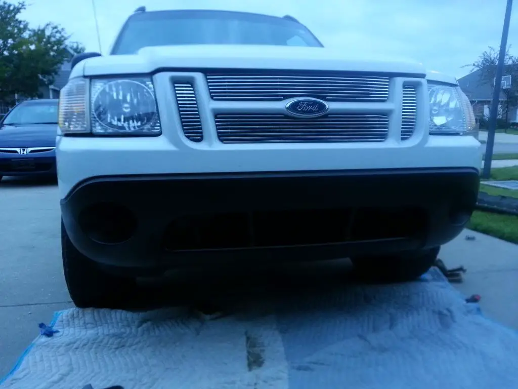

here we go since I just couldnt take it anymore i just had to start on something and i must say i am pretty pleased with the results. tomorrow ill start on the cladding and grill
so here are the results of the grille it actually was a serious pain in the ace for something so simple. reason being i did not want to take the bumper off which gave me very limited room to work with. i ended up just using zipties and you couldnt even tell any differently
only had enough time to paint the front bumper today with prepping and painting. for this i just used the simply green with a scotch scrubby pad thingy rinsed off thoroughly until bubbles are completely gone i let air dry since the weather allowed it i then made 5 light coats with krylon fusion satin black paint then 1 heavier coat about 5 inches from the bumper which i found that it came out amazing i took off the other side claddings and bumpers which i will start painting tomorrow
I like how the billet grille and cladding came out. Not the biggest fan of HIDs without projectors but they look nice too. Keep up the work!
