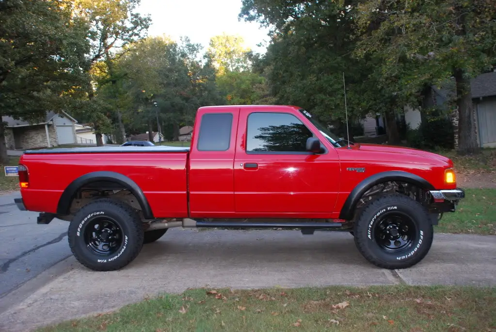

If your just going for function, then the stainless is fine. If you want to throw some eye candy in, then the ceramics. I put ceramics on my Ranger, but who's going to see the headers on a lifted vechicle? LOL
looks good, ive got a set of stainless ones about to go into my 02 ranger.
sorry to get off the point of the tread,
but Scotty J. do you have a pic of the front without a bumper, ive nvr seen one of our rangers without one.
and one of the back to see what the hitch looks like with the body lift.
Click on THIS link, lot's of pics of my ranger in various states of dress LOL.
