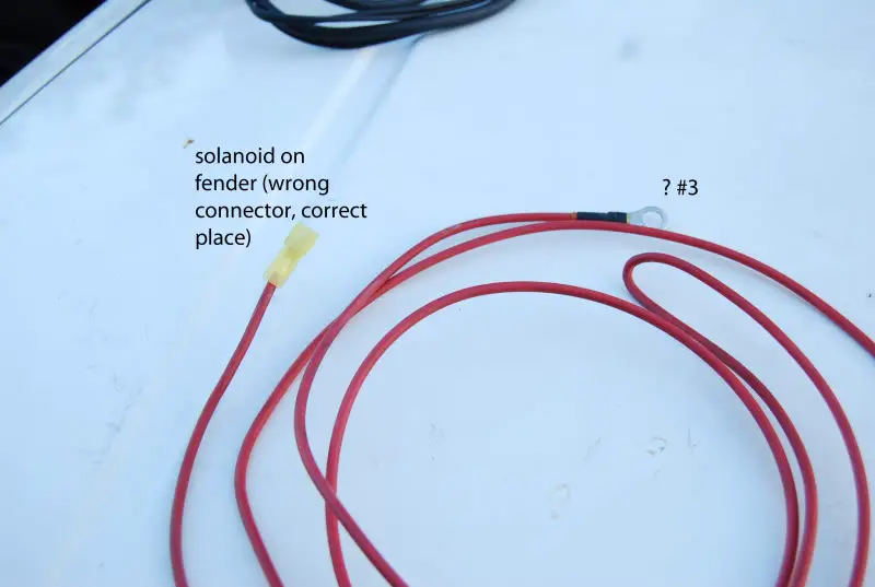

i had the socket on the y-pipe bolt and the handle hit the starter nut that holds the starter>battery wire. i sure hope nothing fried, i dont want to buy a new starter, battery or anything else at all

As for the short fun. Other than "spiking" the electrical system, the only thing I can think of that you may have hurt is the fusable link on the wire between the starter and the solenoid. If there is a fusable link in that line it may be burned by now, but you will know quickly as the starter won't turn over anymore. Other than that, I doubt you did any damage. I've done the same thing a few times working on the exhaust on the explorer and Van..

unless the fuse is on the solenoid itself i dont think there is one?
this is the wire i ran from the starter to the solenoid (whole wire isnt shown, but its all solid wire end to end)
