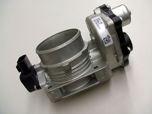

Does your tbody look like this?
See pictures below...If it does, you have a drive by wire system...I believe the DBW system started with the 04 Explorer...
Since there is no throttle cable, I bet the transducer on the throttle pedal bracket needs to be reconnected...
