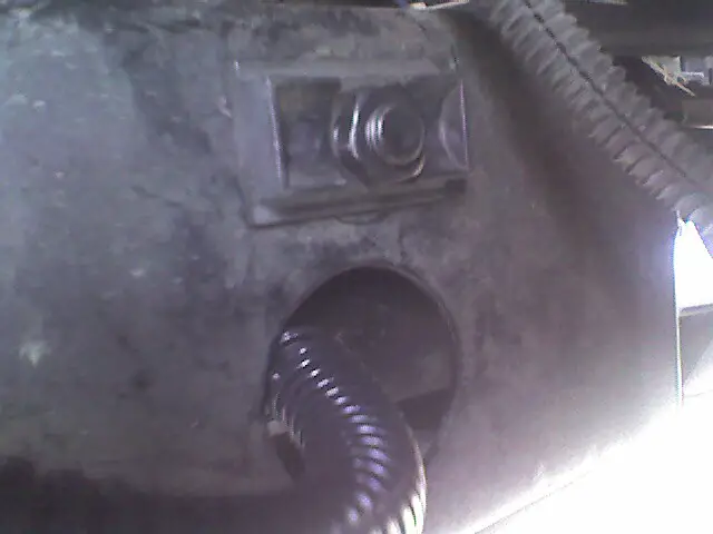

My fault on not sending pics, Bill and Afboy143. I used the same frame bracket that the stock lights mount on. I reused the rectangular spacer from the stock lights to bolt on the KC's. I inserted the spacer between the rear of the frame bracket and the new nut.

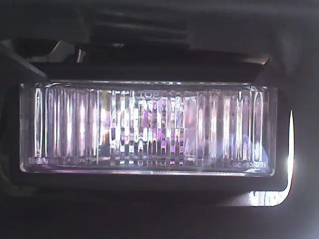

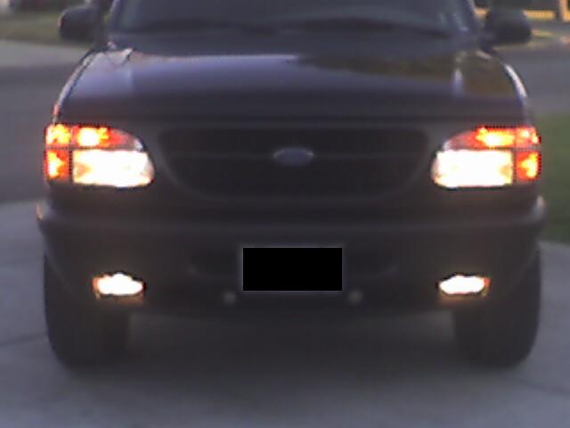

I managed to shoot these with a phone before I lost light so sorry for the crappy rez. Notice the rectangular spacer that I reused to mount the lights in the existing frame bracket. The other side has a square flange that fits in a square hole. I figured it fit and it saved me a trip to the hardware store.

Looking good pabille. Perfect fit. I imagine they put out a lot more light than the stock fogs.
Thanks for the "acknowledge", Bill. They are definitely brighter.
