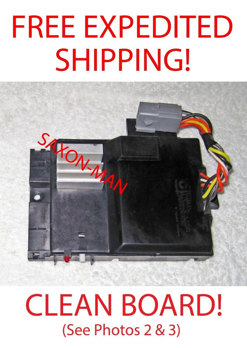

good job thus far!!
You found and tested the ESOF or 4x4CM as they call them (electronic shift on the fly, or 4x4 control module)
Now to find and remove the shift motor!!
