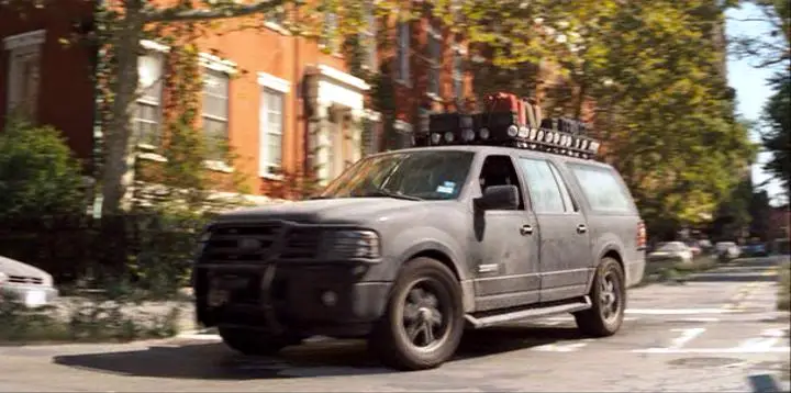

I had a idea pretty close to yours for my wrangler, but after seeing the movie "I Am Legend" I totally wanted to do this to my explorer after seeing Will Smiths expedition haha.
I think he has enough lights though haha. I'm not sure when I'll be getting around to making one myself. But I plan on getting a different explorer first. I think white or flat black would be sick like the expedition.
I have no idea why I havn't got around to saying this before but Buck, you sir are my hero. This is how ALL roof racks should look. I dont understand the 2 inch tall surco racks lol..
Hehe!! Got It! Thanks a lot man!!! I've looked at this expedition too and I tought it was really really awesome and mean looking! :P
