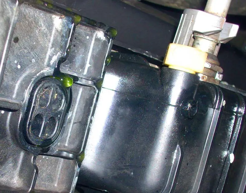

I just replaced my radiator and it pressure tested fine. Hoses are fine and no obvious leaks. Coolant level has not changed. There is no spray of coolant in the fan area or on the hoses.
I do notice, however, that there is a "wet" substance that is almost oily located in the cracks of the black dowel housing at the bottom; the bottom tray that holds the radiator in place. It is not dripping, but the cracks inside of the oval/circle type edge are holding some kind of liquid of sorts.
If this pic posts, it is NOT mine....just and example of the black circular box to the left where the wetness is. Mine does not drip like that but it is always wet in the creases:
Here us the older link to show the pic: http://www.explorerforum.com/forums/showthread.php?t=349625

take a white paper towel and wipe the moisture away then observe its color on the paper towel. If its red its trans fluid if its green or orange its Coolant and if it has no color its just plain water.
AC fluid is green. i just recharged my system with AC Pro and seen that it was green. AC Pro works awesome btw.
