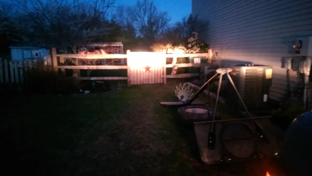

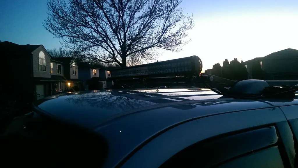

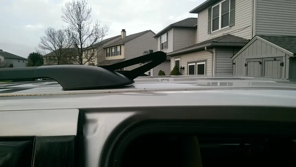

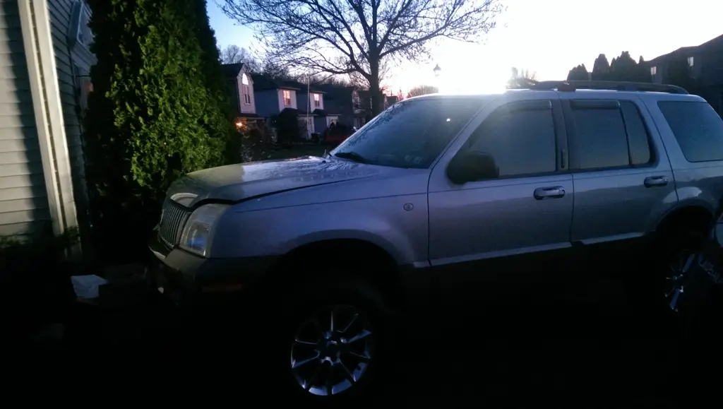

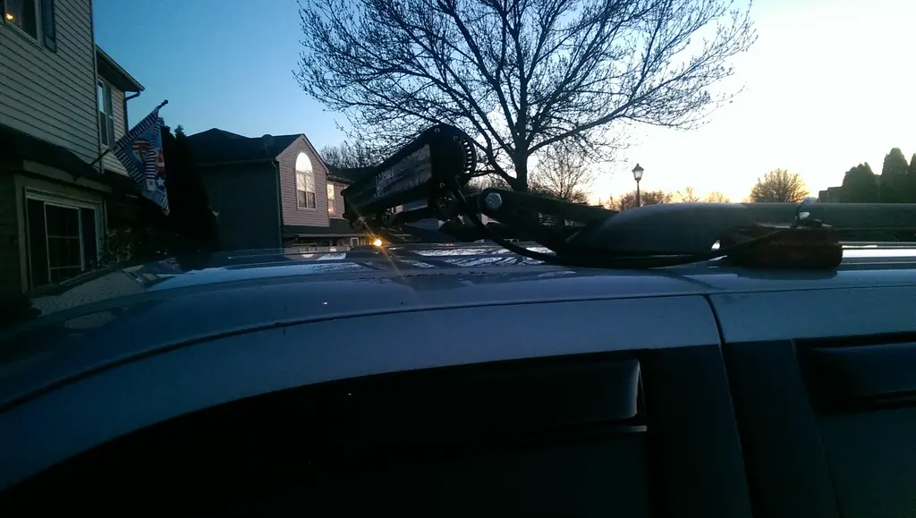

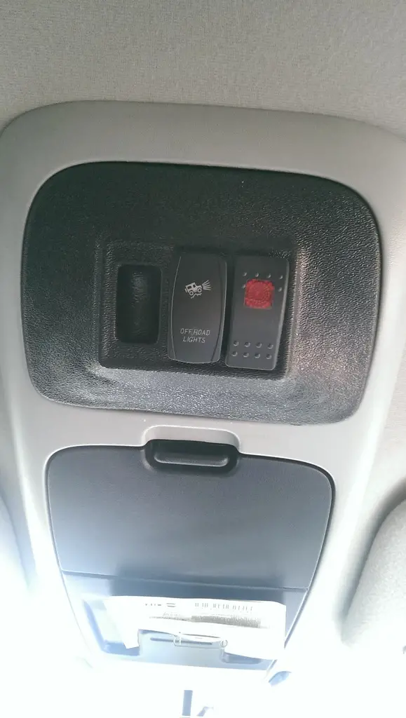

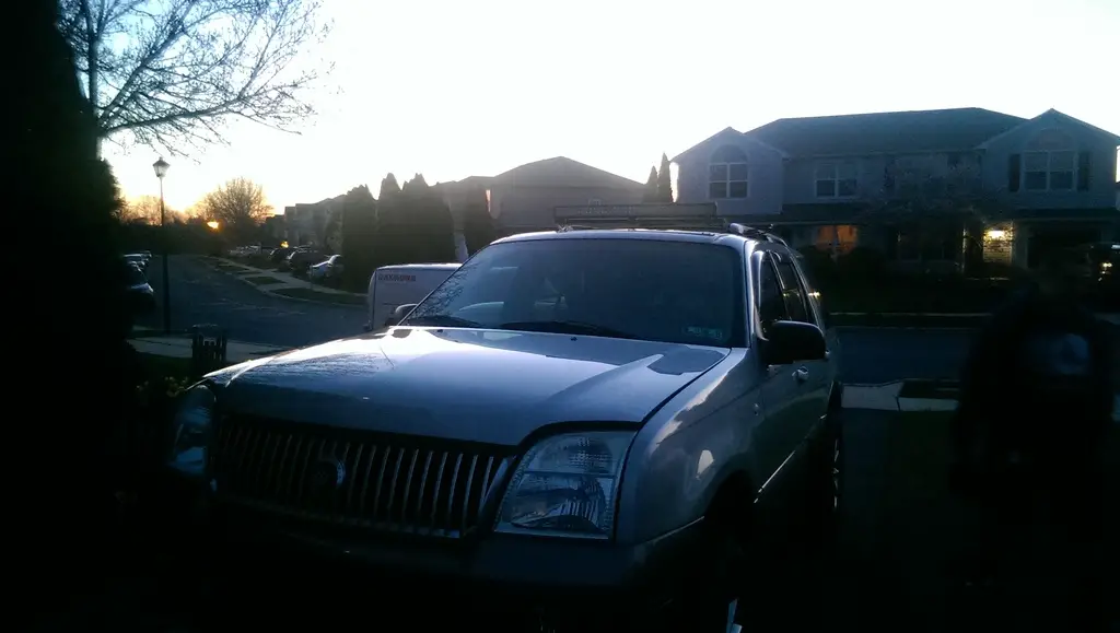

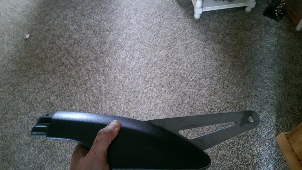

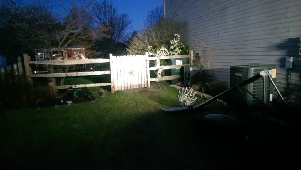

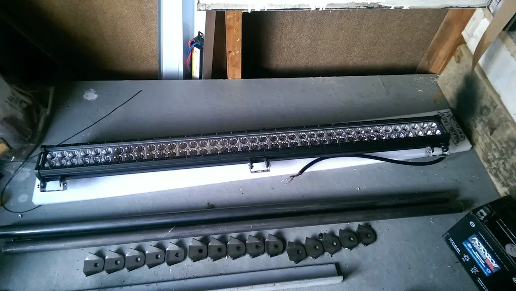

So I have been eying up LED light bars for a while now. While I like the ones mounted towards the windshield, theres no way im drilling into the pillars to install. So i came up with a mounting system that installs under the front roof rack brackets. There is NO drilling into the body required. In addition to the brackets, i made a bolt in bar with mounting tabs so i could mount different style of lights on if i so choose to. In Addition, ive made a custom switch panel that mounts over the factory garage door opener in the overhead console. Anyway, heres a bunch of pictures
Looks good,the bar that far back must be great for eliminating hood glare. Mine lights up my hood like crazy. Notice any whine from it?
There is no glare on the hood. I didn't get to drive it yet (it's down for timing chains) but I'm sure it will be noisy. Lol

WHat size lights did you get? What and where did you get the bracket to attach to the stock roof rack? This is exactly what I want to do. I like the low profile look. Great Job!
It's a 36" bar. I had the brackets custom made. I have one more set I can make up now.

I don't personally like the look of it back there, but big props for a very clean install! Nice job on the brackets.
