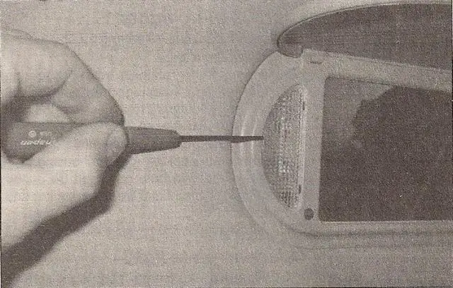

Here's my question. I have tried looking around ask some user's but without luck. I'm trying to change the yellowish bulb from my 2002 XLT Sun Visor, I have tried to take out the lens the complete visor and haven't find my way to get in to the fraking bulb housing. Hope someone can help! :thumbsup:

Use a small, thin screwdriver to carefully remove the vanity light lens:

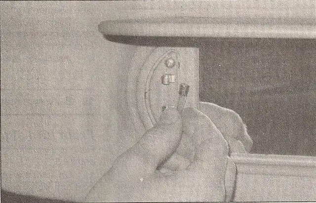

Remove the bulb from the terminals - if it necessary to pry it out, pry only on the ends, not on the glass:
Hope this helps out!

Thanks a lot Big Rondo, Now I own you two cases of Medalla Beer.:salute: Happy Holidays! From Puerto Rico Sunny Days Around 80's degrees all day long. NICE!
