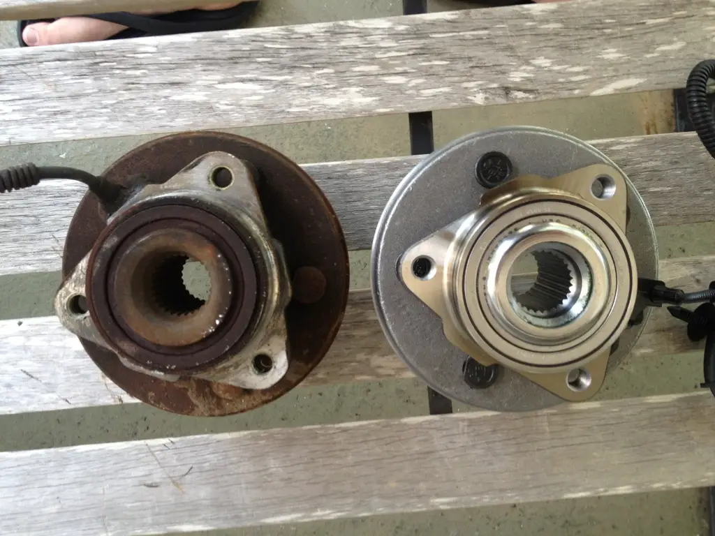

Here is mine from when I replaced my front drivers side hub.
Old and new:
