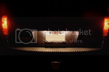

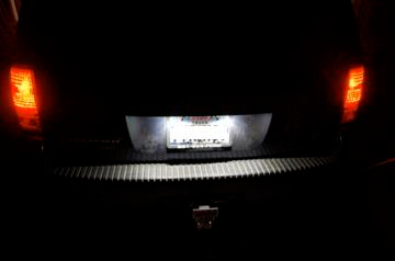

Decided to go LED for the lic plate
before
after
I like the white color vs. the yellow filament bulbs.

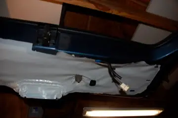

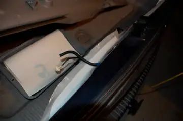

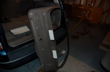

Need to remove the entire panel from the rear door.

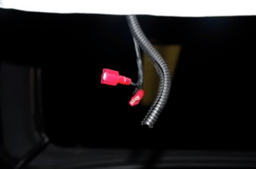

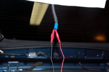

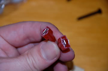

I cut the incand. domes from the wires, and installed some plugs to allow for changing the LEDs, in case I need to in the future.
When you remove the incand. housing, you will need to cover the remaining hole. I just cut a piece of plastic in the approximate shape, drilled a small hole in the middle (to run the wires through), and cut a small line from the edge of the plastic up to the hole, so I can run mount the wires after installing the big red connectors.
I used 3M double sided foam tape to mount the lights to the truck.

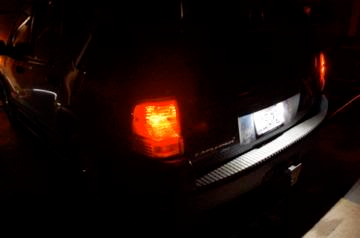

here is a pic of the ones i got they were 8 bucks at a&a...
heres the bulb
and heres what they look like when turned on
Sorry it took so long to get back to you i have been very busy w/ school... they are not as bright as your but it beats cutting up my wiring..
