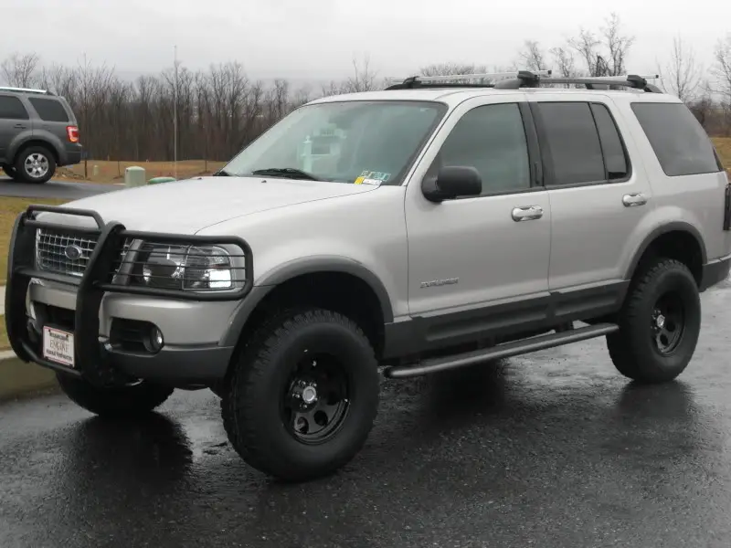

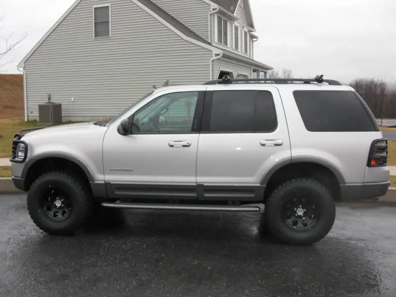

Im running 2.50 front and 2.25 rear lift spacers with Pro Comp 265/75R16 (31.5x10.5R16) tires and Pro Comp Rims 4.50BS and 0mm offset.
No rubbing issues!!
can you post some pics up pa? i wanna see how the tires fill out the fenders
Let me know if you recieved my PM!
got your pm but it was blocked too
I sent you an e-mail with the link, if you cant access it this time I will try and post pics tomorrow!
still cant access it bro ... just post pics up when you get a chance thanks man
