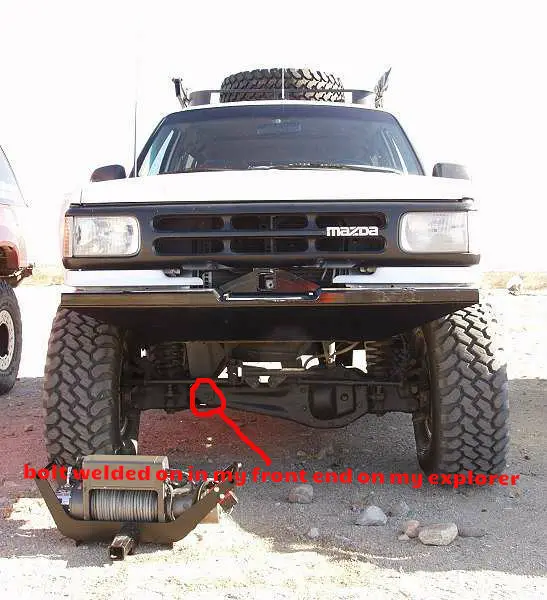

i want to stay with 33's as i do mostly town and highway driving. and as it is i have major bump steer and on the highway its a b***h to handle if theres any wind and i cant align it properly because the bolt to move the front axle is welded on i would post a picture but cant figure out how

Welded on???? There shouldn't be any bolts welded on. Can you post a picture so we can see what you're talking about?
sorry i tried adding a picture of my truck ill take a picture tomorrow of the bolt im talking about

Need a pic of the welded bolt to know exactly what's going on there though.
Edit:
I see your pic, that looks at least 5" lift to me. Might have some work ahead of you if so.

heres the bolt i was talking about. i found the picture on bing so though i would add it to give an idea of what i mean
sorry it didnt add the edited picture, its the left bolt on the axel
