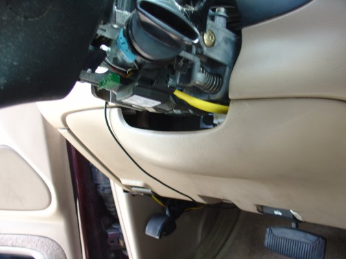

Mystery somewhat solved or at least identified:
At least I now know what is triggering the chime; I can even silence it by using my finger.
There is a blue colored “switch” of some sort on the ignition key cylinder ( lower left side ). By pressing in on the blue thingy with my finger, I am able to silence the damn chime. Further, the lights on with no key in ignition and drivers door open works perfectly as long as I am pushing in on the blue thingy.
QUESTIONS:
(1) What is this blue thingy?
(2) Is it replaceable independent of the ignition key cylinder?
(3) Ideas or suggestions??????
Thanks in advance; that chime is driving me nuts ….

Here is a better picture of the blue thingy .........

Its probably just worn out/loose, i have to wiggle my igntion sometimes to get it to stop beeping when the door is open even when theres no key.
Problem solved, really:
At first when I reinstalled the covers, the chime still sounded, however, after repositioning the covers and tightening the covers, the sound ceased.
But what in the world is the name of the Blue thingy?
If I remember right, when I had to change my clockspring, my chime sounded constantly. Right where that blue thingy is was a black wire that plugged into the ignition assembly. I just took that wire loose, and now I get no chime at all as far as doors being open. The door ajar still lights, and if I leave the headlights on with the ignition off the chime does sound.

Almost 10 year old thread, but still no answer to what that blue thingy is called. I replaced my mfs today and when reinstalling the column cover I noticed that thing hanging by its wire. I put it where it looked like it fit and closed it up. Now I have the chime with key out, lights off and door open. Chime silences when door is closed. I would rather repair properly with a new part if necessary.

to answer the blue thingy question. That is you PATS (Passive Anti-Theft System) Exciter ring. It is what talks to a security chip in your key. Your truck will broadcast a radio frequency that energizes a small coil of copper in your key that energizes the chip in the key. The chip then sends a small code broadcast back to the truck. The range in which this works is very short, and so it is important for the key to be as close to this ring/antenna as possible.
I don't know if the PATS name is correct for the older vehicles that don't have a chip in the key, but I see some listings labeled
"Ford Key In Cylinder Warning Buzzer Chime Alarm Wire"​
or
"RANGER MUSTANG KEY BUZZER WIRE"​
on ebay so for anyone looking to replace one, you might want to start there to find a replacement.
