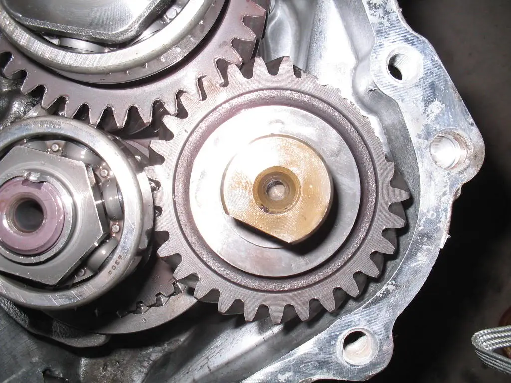

ok so now that i got this thing off. i pulled the top case.
it appears one of the gears is eaten up.. towards the tailshaft. on the very bottom.look see.. what gear is the chewed up one??
is there anything wrong up front? it looks fine to me have a look see?
heres a better pic of the chewed gear.. with the tailhousing off

if im not mistaken, thats your reverse idler gear missing teeth, and judging from the damage, i would be worried about just slipping another gear in there and running it. the metal shavings proably killed your bearings.
btw how the h@ll did you do that?? put it into reverse on the freeway?
i was in a parking lot, i went to put it in reverse, and i heard a clunk... then i put it in 1st and it just locked up!!
