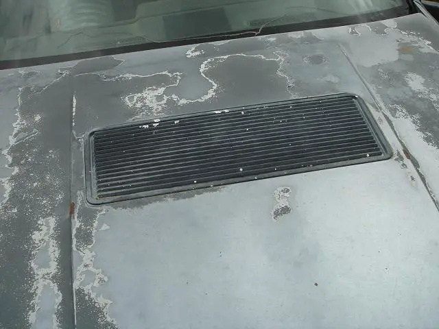

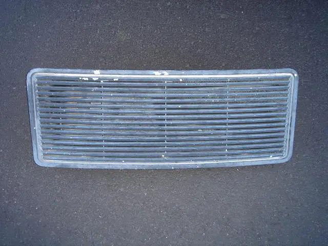

I have been on Ebay for weeks trying to get some Dodge/Chrysler Turbo vents.
I happened to mention that I preferred the Daytona Turbo vent, instead of the Lebaron two smaller one to a seller. Well he was super nice went out and found it for me in the junk yard he gets he parts from. I comes complete with the drip pan. Now that is going to save me tons of time trying to Jury Rig it.
I am hoping to install it forward on the hood to sit just after the radiator (if it fits flat on that part of the hood). This would take great advantage of the rising heat. If it it looks like the curve of the hood will be a problem, i will sit the vent further back above my intake manifold.

I hope it works out for you. Are you going to have enough clearance?
I have seen it done before on a gen3 like mine by a user named Anrev (can't find him). It was set back on the hood, but I don't know if it had the drip pan installed. I really would like this right in front of engine to vent all the radiator heat right out the top. I can always make a new drip pan if needed.
