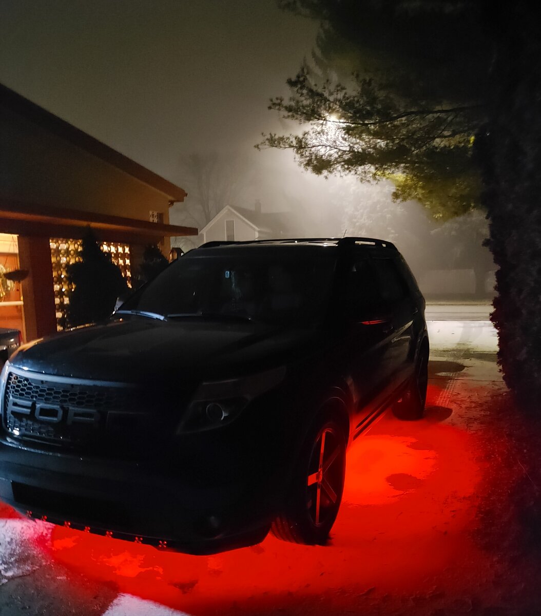

I got my 13' explorer a year ago with 96k miles on it. With any used vehicle, there were a few cosmetic things that needed replaced. Sense then ive put about $1000 into it cosmetically and $400 into the engine. I love the vehicle overall and yes there is still a few more things I would like to do soon. Now I have a slight hesitation in the tranny (110k miles) and am going to flush the fluid and replace the filter.
