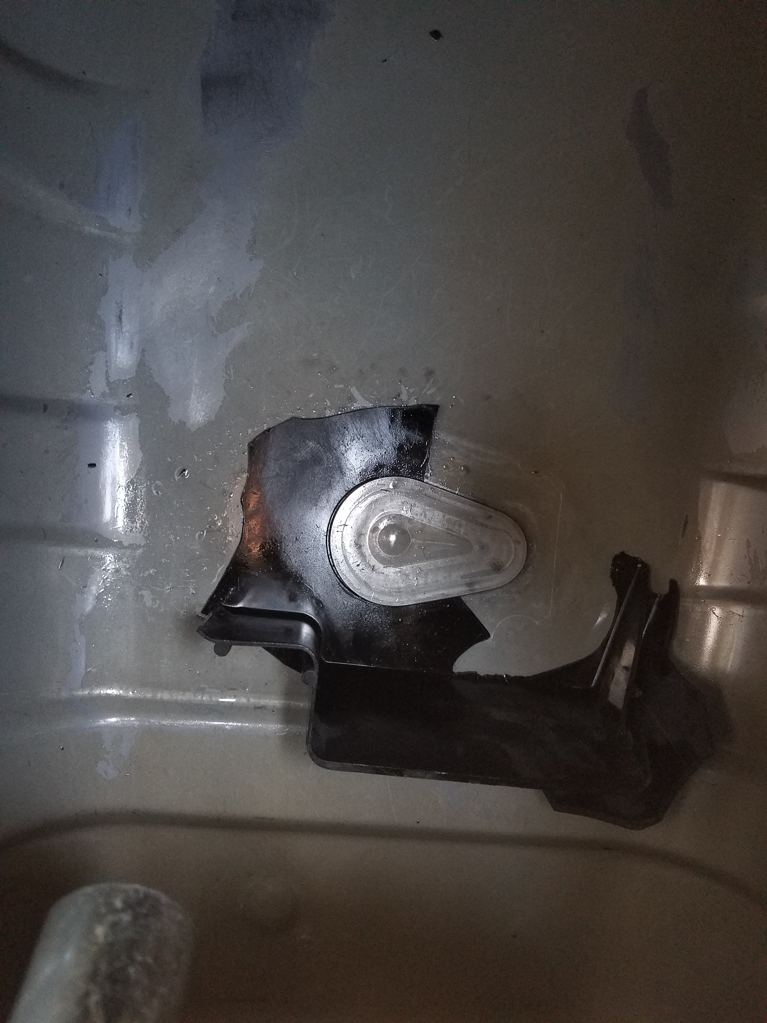

I took the tank out again, to remove the loose baffle, but I did a dumb thing. I didn't really examine HOW the plastic baffle was attached to the metal tank, and just broke it out of there. Turns out, the metal tank has a ridge where the plastic baffle slides under. I may have been able to slide it back into place. I do have to wonder, though, that if it came loose the first time, that it would be likely to come loose again.
Anyhow, time for a new tank.
Does anyone have personal experience with the aftermarket tanks? I saw the one listed above on eBay for $108. Dorman offers one for about $250, and Spectra Premium offers one for about $250. Do they all have the same baffling, material, etc? The Spectra unit is tern-plated steel, with a steel interior baffle.
Here's a pic of the broken baffle slid back under the metal tab inside my tank. The full plastic baffle has an oval to match the metal tab.
