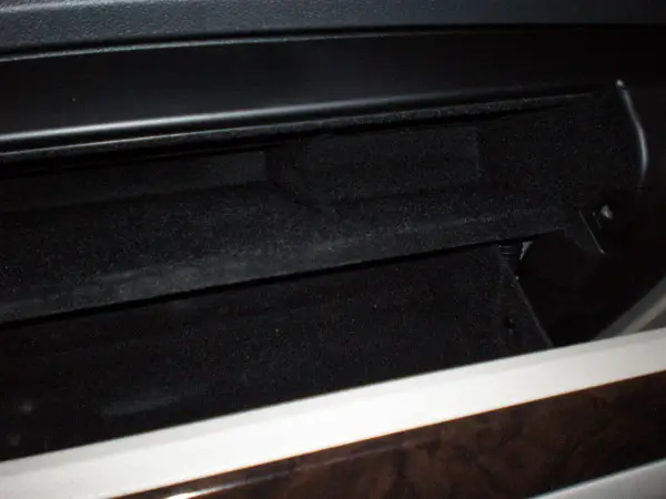

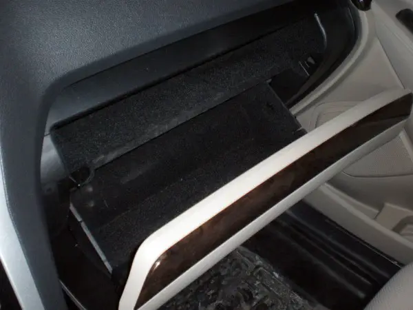

Ok, so I read the forums and I used some double sided tape and velcro, placed it over the rubber bumper on the left side and that solved the rattle. Here's another issue: I think pieces of my glove compartment door are missing. Is there supposed to be some sort of cable on the right side? I see a place where something slides in, but nothing is there. Does anyone have info or a picture of what is supposed to be there? Thanks for all the help so far. This may have something to do with why the door is so loose.
There isn't any cable or anything like that on mine. The only thing I have is the switch for the light on the left side.
