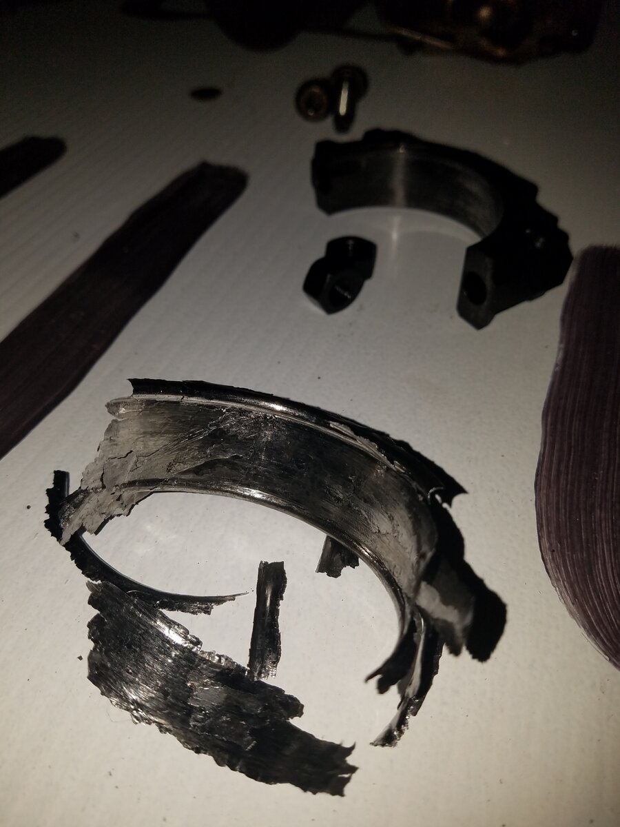

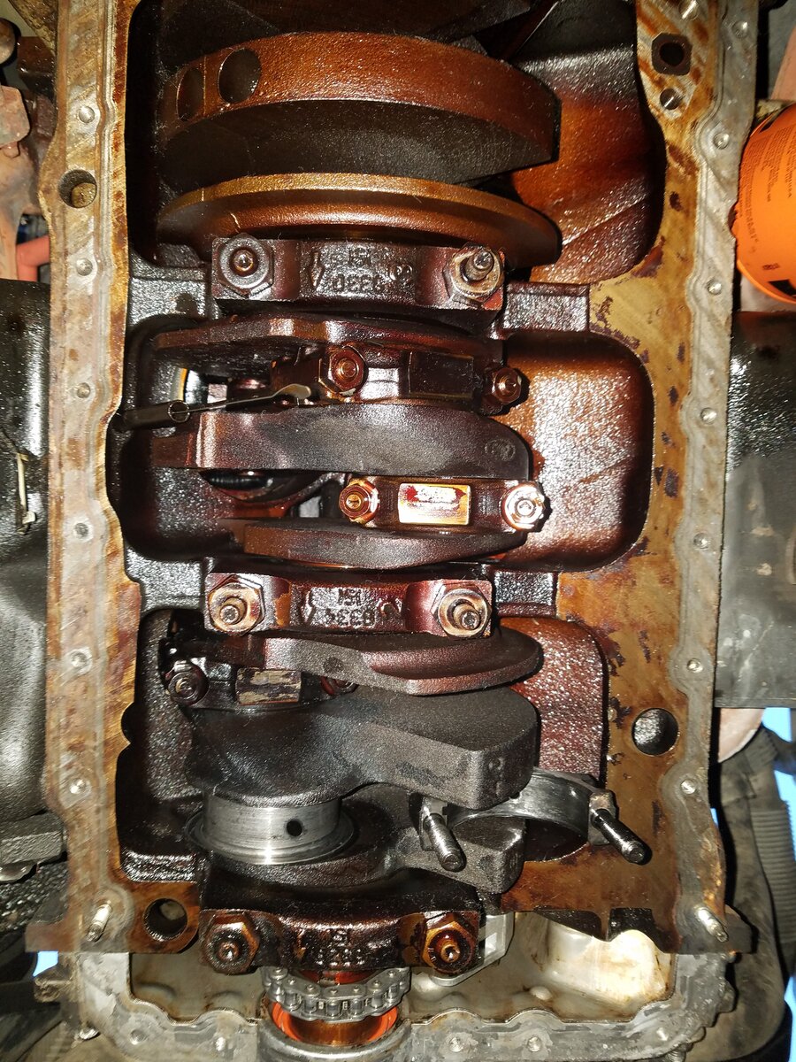

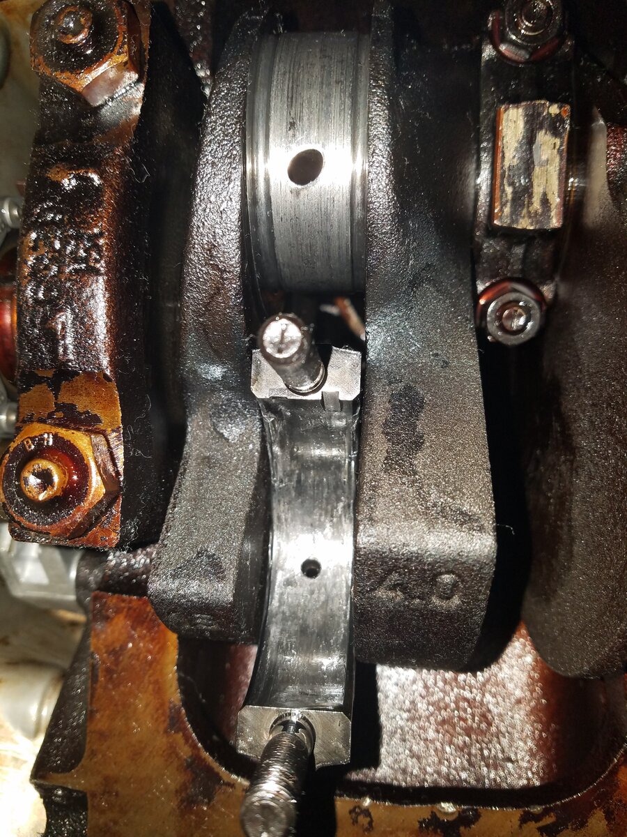

I had a 4.0 OHV do this. Timing chain tensioner is hydraulic, and partially plastic. When it breaks all your oil goes out and back to the oil pan through it instead of the rest of the engine. Does the clattering sound like a bag of hammers swinging around in the block? That's your connecting rods banging on the crank journals since the lack of lubrication has by now destroyed the lead bushings in the con-rod ends. Running it like this will destroy your crank and con-rods next, and possibly the rest of the engine. My engine is still sitting in the barn waiting for a rebuild with new crank and con-rods.
