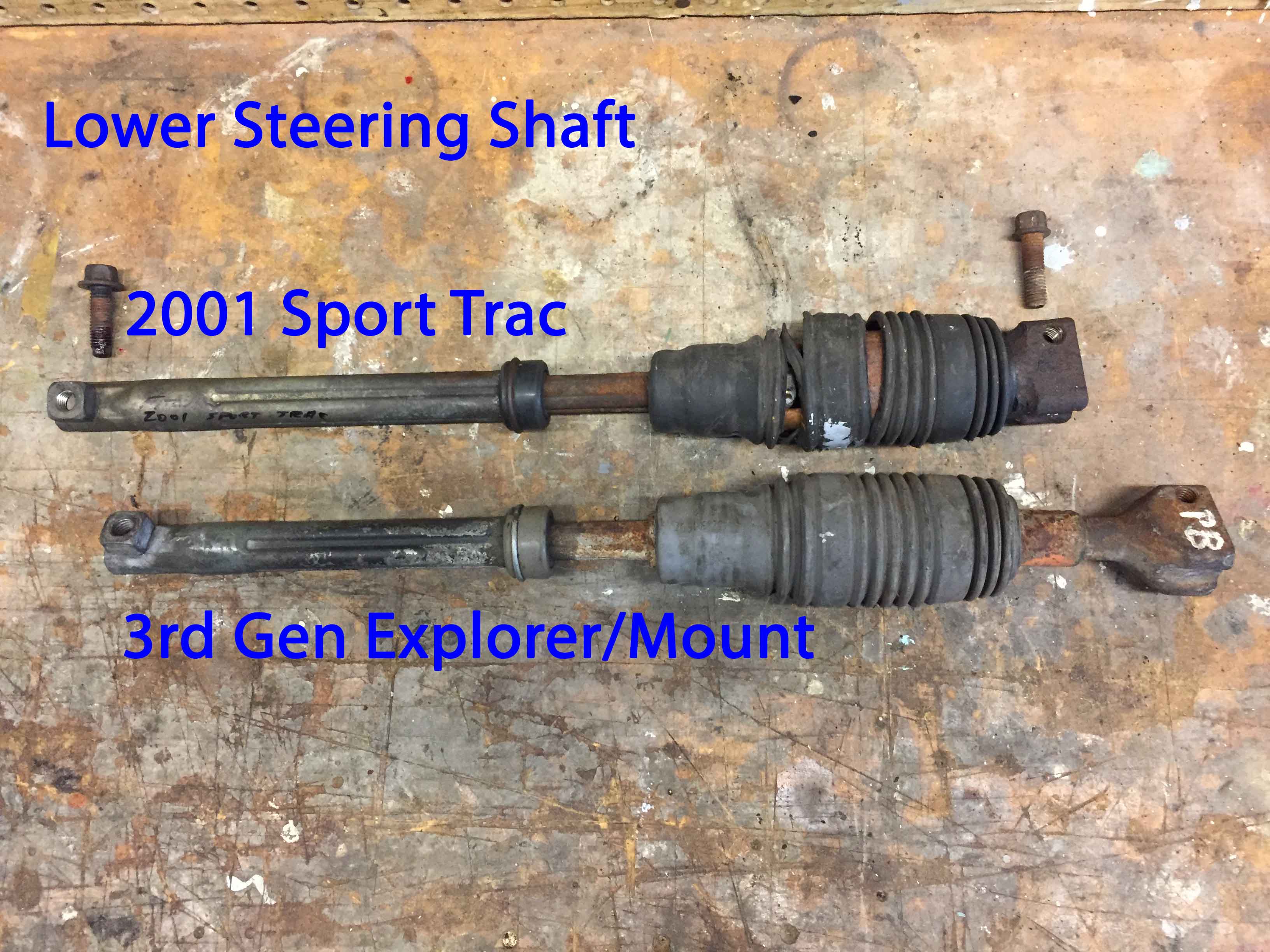

I've found quite a bit of play in steering on my 2001 Sport Trac, and traced it to the lower steering shaft.
I thought I had found a replacement in a junkyard, from a 3rd generation Explorer/Mountaineer. But closer inspection shows the parts are different. See picture comparing the two. Although this part will physically fit both ends and connect, the extra space between the lower connection and the U-Joint causes it to collide with the tubing support block on the driver's side.

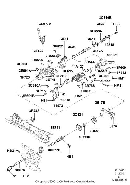

The Ford catalog shows this as part no. 8l5z3b676b, referred to as only 3B676 on the attached.
Any other suggestions for a good, used source for this part?

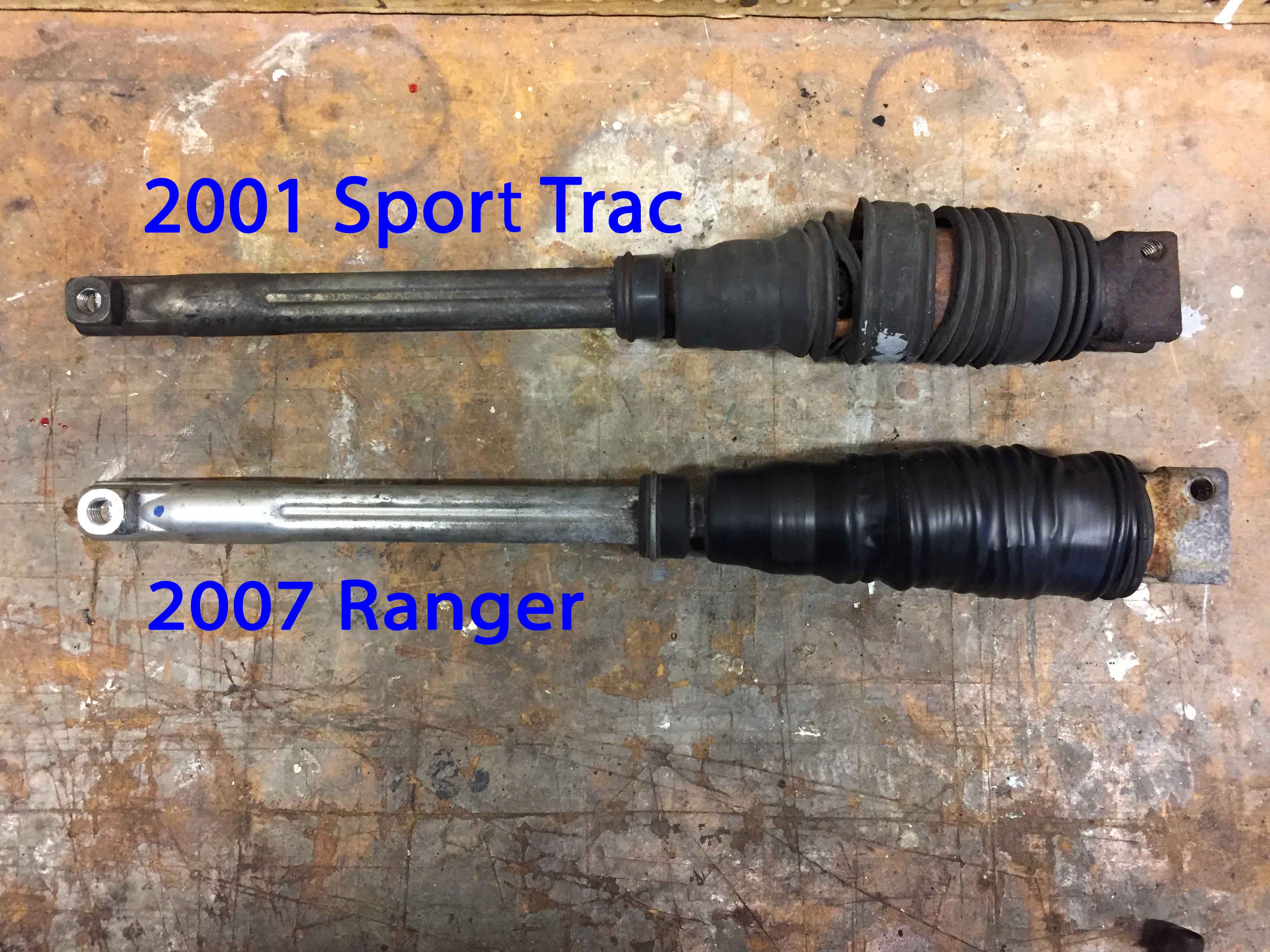

The yard that I got the other shaft from found a Ranger with a matching shaft. It was tight, no play, but the boot was ruptured.
A few wraps of electrical tape made it look a whole lot better. Installed easily and really tightened up the steering.
Any other suggestions for a good, used source for this part?View attachment 95520 View attachment 95521
